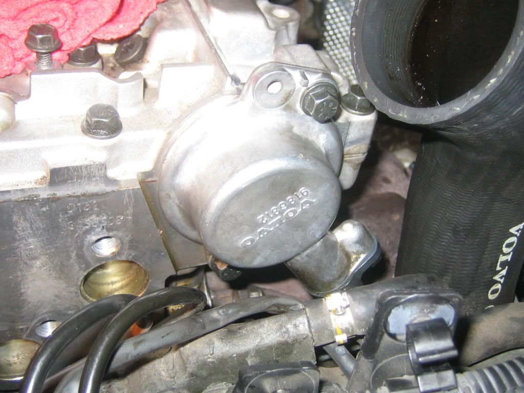

Default 2000 S40 Mystery Hose
I have coolant leak from a small J shaped hose that I am having trouble identifying. In the picture the hose is located just below the camshaft sensor... you can see the one end that is connected with the shiny ear crimp clamp. The other end of the hose drops down and connects to the engine block which is where leak is. Any idea what this hose is and has anyone ever changed it? Thanks in advance.

Im guessing that would be one of the hoses which is part of the pcv system. See the link below. I'm not sure you can buy the "j" part separately. You may be stuck buying the whole thing or heading to the junkyard for a partial replacement.

Thanks for your reply and you are correct on all accounts... the hose is part of the PCV assembly and it is not available separately... $120.00 US from the dealer. Might have to jerry-rig a piece of pressure hose if I can determine how to gain access to the bottom connection as it's in a really tight space not to mention the ear crimp clamps on the hose will have to be cut off. Has to be the worst place for a coolant leak....Time for a little prayer.....thanks again.

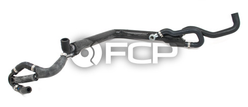

I did speak to both Volvo and FCP and both say that the hose I need is sold only as part of the crankcase vent hose assembly.... In the photo on the right side it's the small piece with the metal fitting on the end in that curves up and back to the left. I'd hate to have to buy the entire assembly just for that portion.
