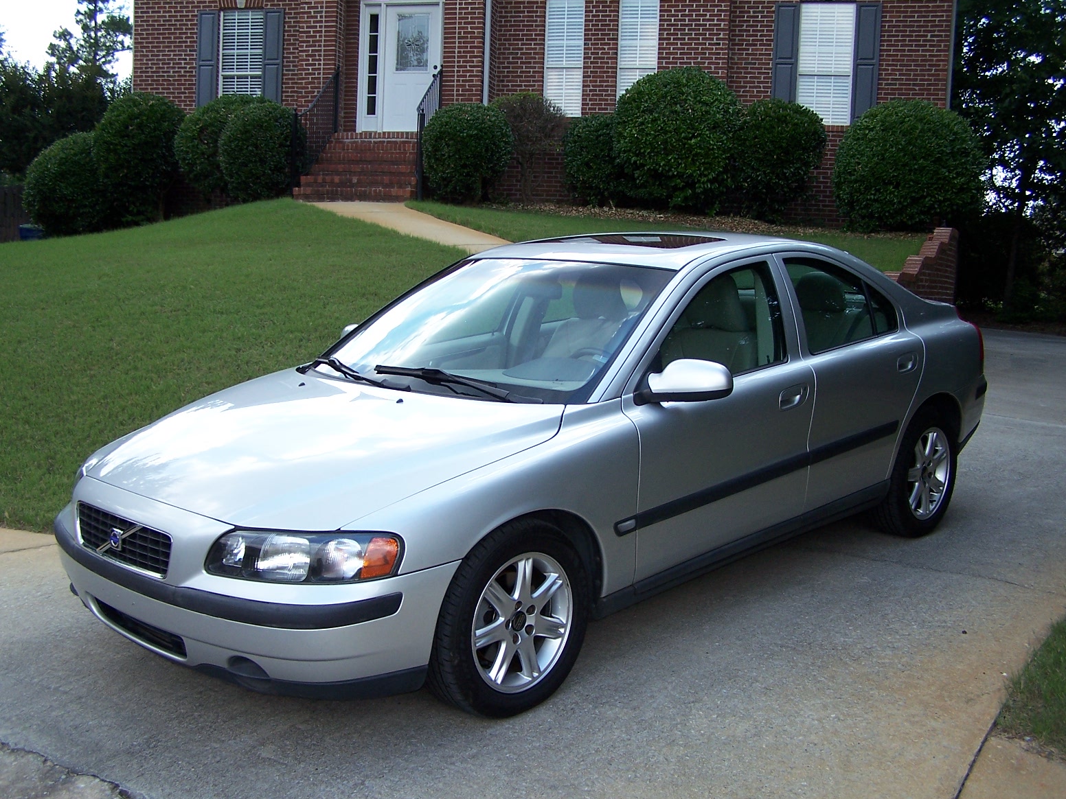

I suspect that you have a blown head gasket due to low coolant the first time around. The 2.4 is a simple engine to work on and I just finished a 2.4 T that we sold at our dealership. In that case, we didn't have overheating issues but I noticed some coolant on the oil cap and the crankcase breather was full of sludge. We pulled the cylinder head, had it flattened, installed new valve seals, had the oil pan removed and cleaned and finally, installed a new crankcase breather box.
I think that you need to do the same repair that I did. That's my suggestion from your story.
