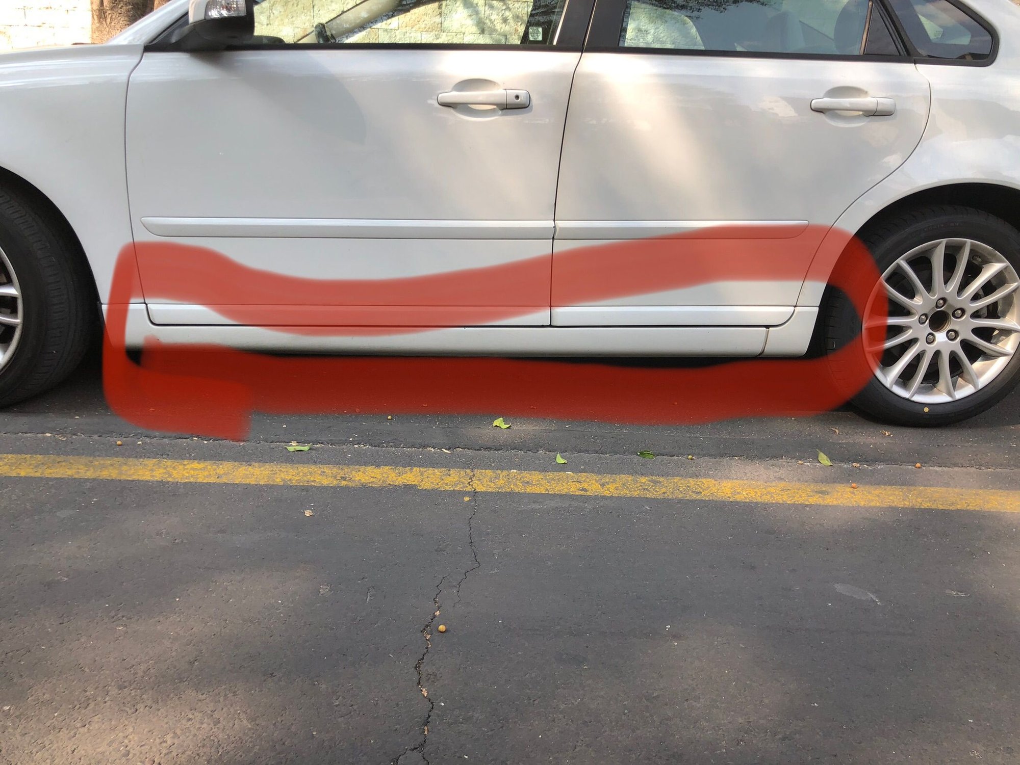

I have a 2009 Volvo S40. I need to replace a part, but I am have a damn hard time understanding what it is called or finding a part number. It is a plastic piece (two pieces actually) that run between the front right wheel well and the back along the bottom of the car. See pics.
What is this part called?

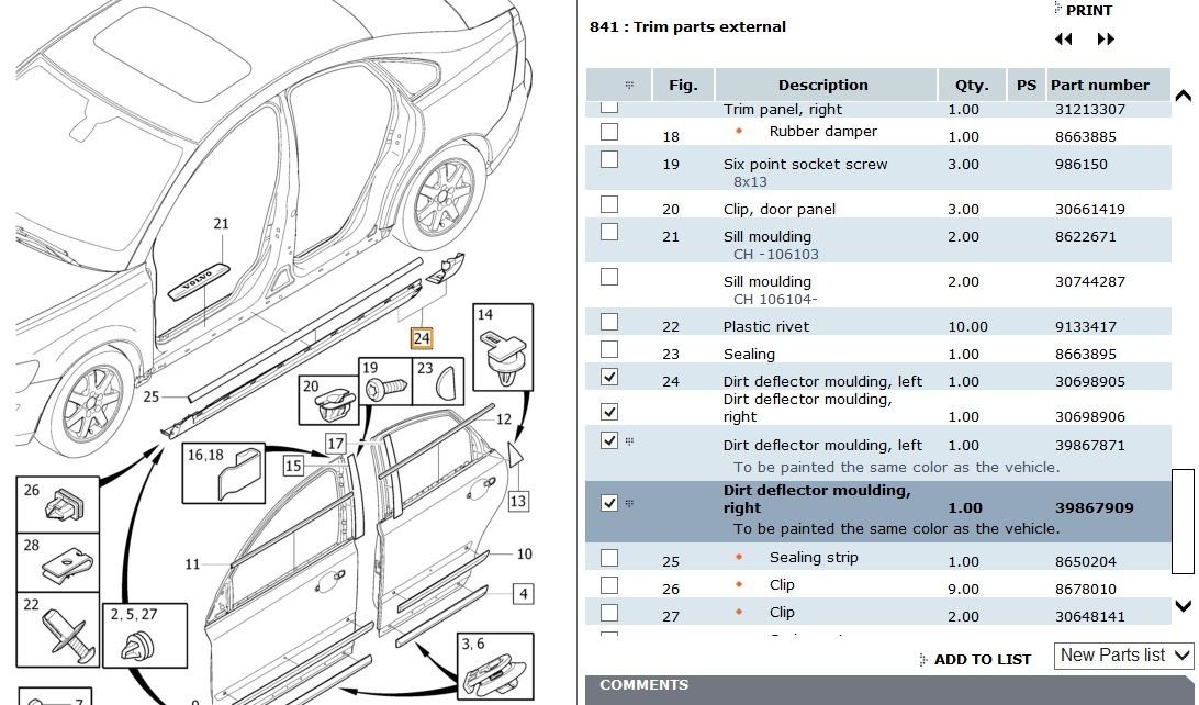

The rocker molding? #24
