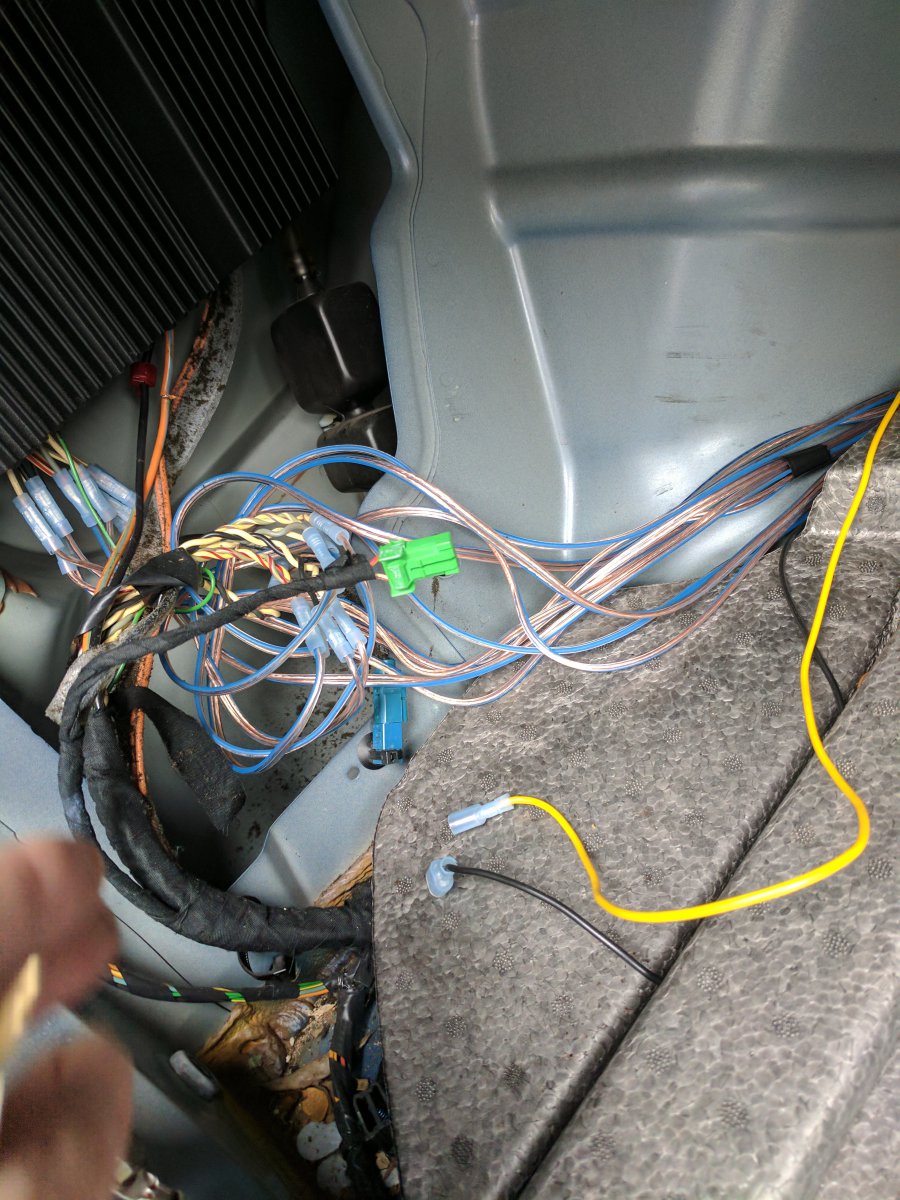

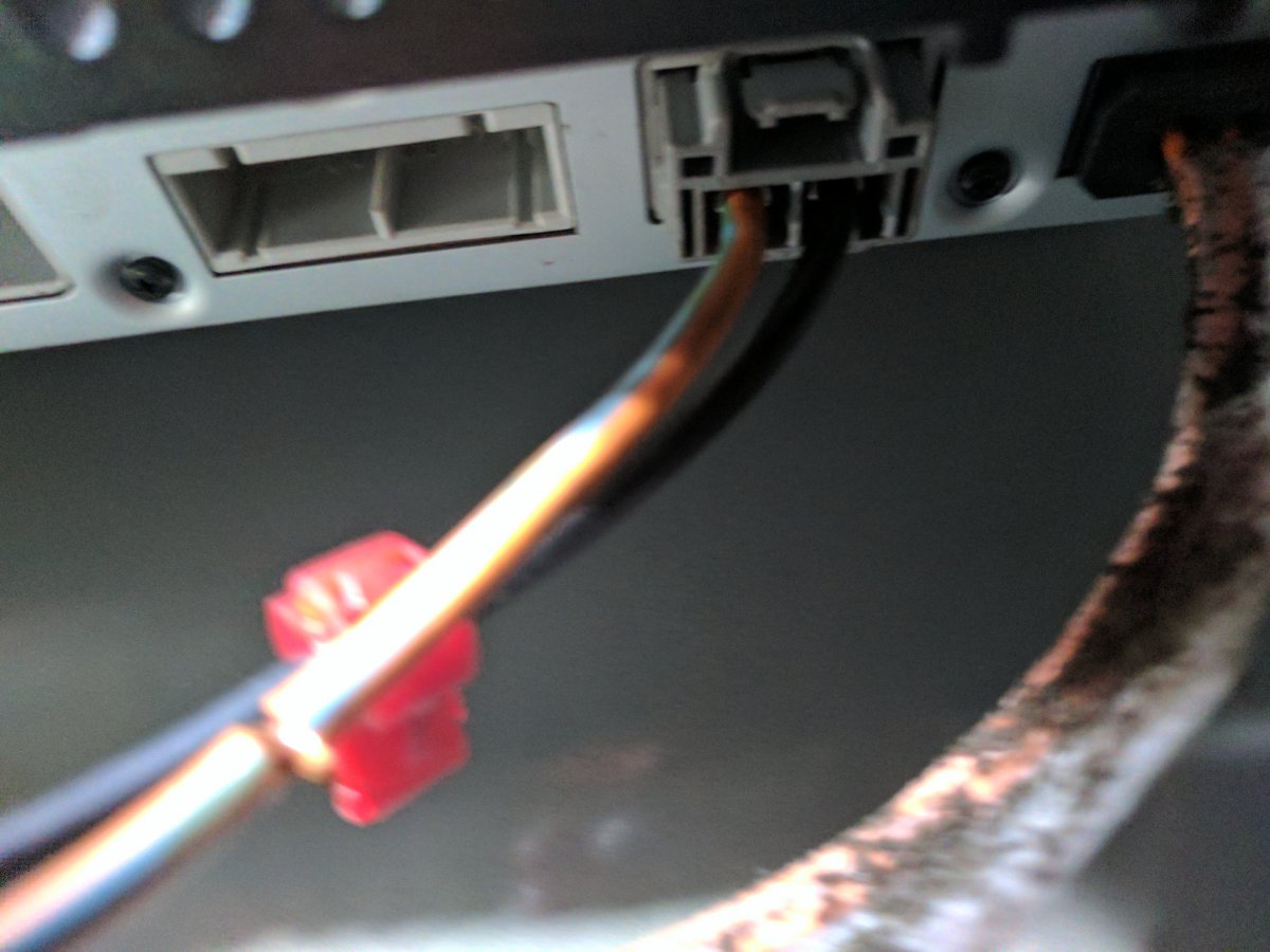

06 S40. I just bought it.
radio/CD displays but no sound comes out. wires by amp look modified. At first no radio or CD on display. big green plug was unplugged from amp so I plugged it in, and then display worked.
I have a voltmeter burried somewhere, haven't found it yet.
Can anyone make sense of these wires?
1. What's the stray green plug.
2. Any idea about the other 2 stray wires with Spade connectors?
3. Is there a list of what audio wire colors go to what? (Particularly the audio wires going through the trunk)?
Thanks in advance! The kids are asking me every day if the radio is fixed lol

Perhaps a wiring diagram will help (attached)
