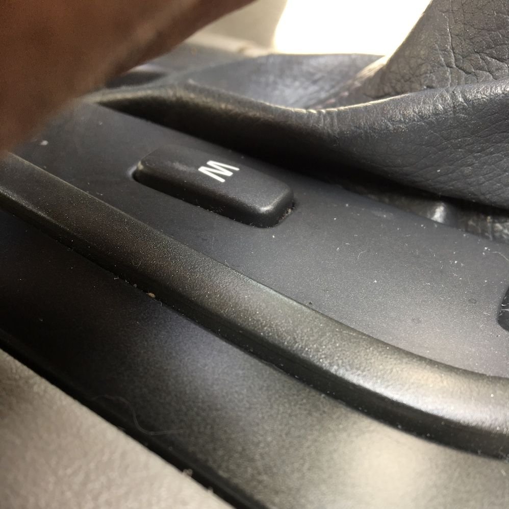

I bought a used 2003 S40. When I press the "W" button, it goes down slightly (maybe about 1/8 inch?) and I don't see any indicator light by the button or on the dashboard telling me it's been activated. Am I supposed to see something?

I see nothing light up on my dash when I press the W button, and while the button does depress about 1/8 inch, it appears to come back to the same height, and I don't feel/hear a click.
And no, it does not feel like it's starting in 3rd gear. The car just drives the same whether W is pressed or not.
I guess my W button is broken? I wonder if that is why I have the check engine light on.

if your car is starting out normally, then W is not engaged. If you feel it start in 3rd gear and there's no indicator light, then you may have a bulb issue on the dash. If your button doesn't change the car's behavior, then you likely have a switch issue or wiring from the switch to the TCU.

) that shows that the winter mode is indicated by the "up arrow" in the instrument panel. That never turns on/off for me in my car (other than as a flashing yellow that comes on with CEL). AND my car does not respond to the W button being pressed. So I would guess that there is something wrong w/ the W switch, possibly along w/ other tranny issues. Thanks for your response!
