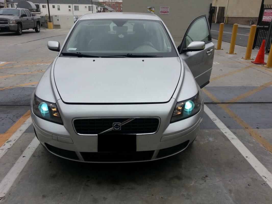

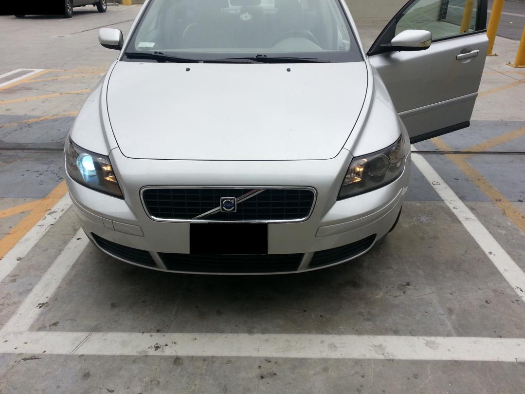

First of all, I'm new to the "attempting new things on my own car" area so I may not be using the right terms to describe what I want to say. I'll try my best to explain.
I've been researching the best I could but it feels like I've run into a brick wall...
Approximately 2 weeks ago, I've bought a HID kit from a friend (in hindsight, probably not the best idea)
We installed both high-beam & low-beam together and it seemed to work perfectly fine as long as it the light setting wasn't set on auto.
Approximately 24 hours later, both lights started flickering (low beam only) and after an additional 4 hours, my driver side headlight (low beam) wouldn't turn on.
After consulting with my friend, he has gotten me a new ballast for the driver side and we re installed.
Again, after a very short period of time, it didn't turn on.
To possibly resolve the issue, we obtained that cable thing (can't remember what it was called) and connected directly into the battery. To be honest, it looked very stable.
After driving for about 200 ft (if that), the driver side low beam just turns off (no flickering or changes on the left low beam). I thought it was weird so I turned off the car and started that car again at which point the light came back up. But once again.. < 200 ft and the light turns off.. (pictures show right before the drive.. and one small lap around the parking lot)
Any input on why this is? and possibly how to fix the matter?
Attached Thumbnails Volvo S40 newb needs help with his HID-20130612_095910.jpg   Volvo S40 newb needs help with his HID-20130612_100234.jpg
