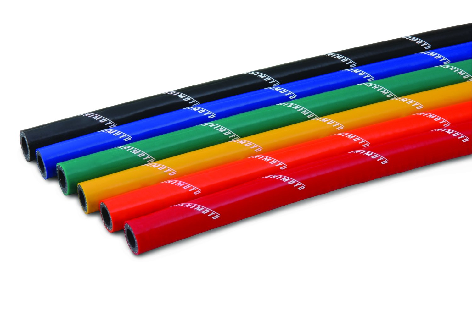

If i see that i need to replace some perished vacuum hoses are there any recommendations ? What diameter are the vacuum hoses ? Are after market upgrades worth doing ? I'd consider upgrading to some fancy red ones like ones pictured here if I was going to the trouble of changing then why not upgrade I'm thinking !
