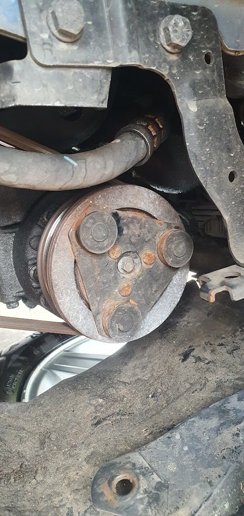

I decided this morning to take the wheel off and check the spacing with a gauge (to make sure I'm not buying/renting/making the tool for nothing). To my surprise (not really, I'm used to it by know) ... I find a Ford AC Compressor:
From what I found in shops and etc, my compressor is the VS16 160ml oil version.
Does anybody know if the same can be done with this one? Besides the middle bolt (M6 btw), I can't find any other bolts there. Hence, I can't think of any way of using a harmonic balance puller. I tried to "remove" those rubber caps, just in case there are bolts under them, but I can't get the to budge, so I'm guessing that they aren't removable.
Those 3 small protuberances are not bolts btw, they are just solit metal plugs/rivets(?).

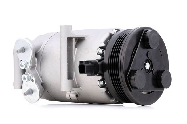

This is a photo of a new one btw:
Any info would be appreciated. Thanks.

Apparently you don't need any puller for this one. I took the M6 bolt out and it all came apart. There was a single M6 x 11mm washer with a thickness of 1mm. You could probably change it with a slimmer one. I ended up not being able to fix mine, the bearing inside there is shot sadly. I'll replace the whole compressor since idk if anything else broke when that bearing went.
