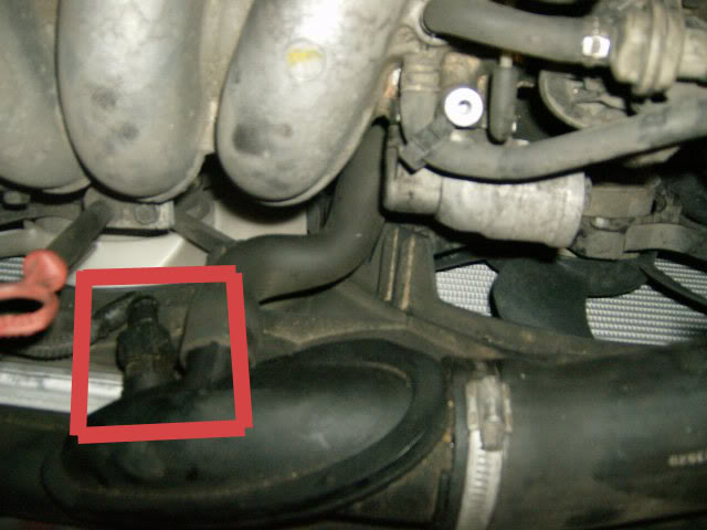

The clogged PCV system whistle is for the newer 2004.5 and up 2.4L and 2.5L engines, not the 2000-2004 1.9L turbo engines. For the 2002 I'd do what mt6127 said and check your intake tract from MAF to the throttle body. With a MAF equipped car all the air is accounted for as it comes out of the air cleaner box. If you have a leak then it really messes up the computer. One known fail area is the S shaped hose between the intercooler and the throttle body. You can see it here where it starts in the red box. It gets brittle and cracks in two eventually.

That hose next to the square is a big culprit as noted. It leads to the idle air control valve (which also benefits from cleaning).
