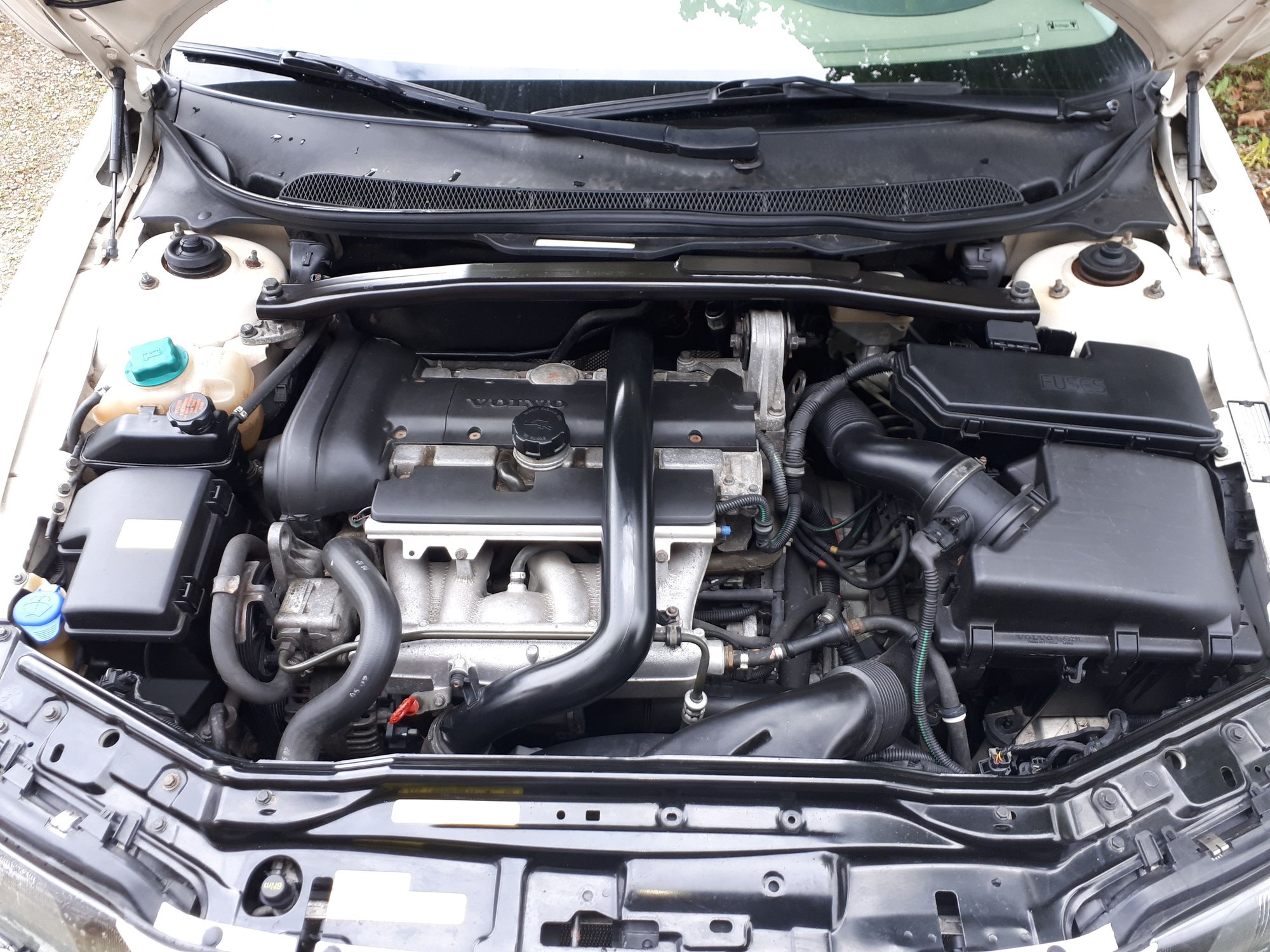

I also cannot find the fuel regulator/damper/sensor on my engine... it is not attached to the side of fuel rail.... nothing online or YouTube to clarify this....

Oil at base of coupler...
Where is fuel regulatir/damper/sensor?

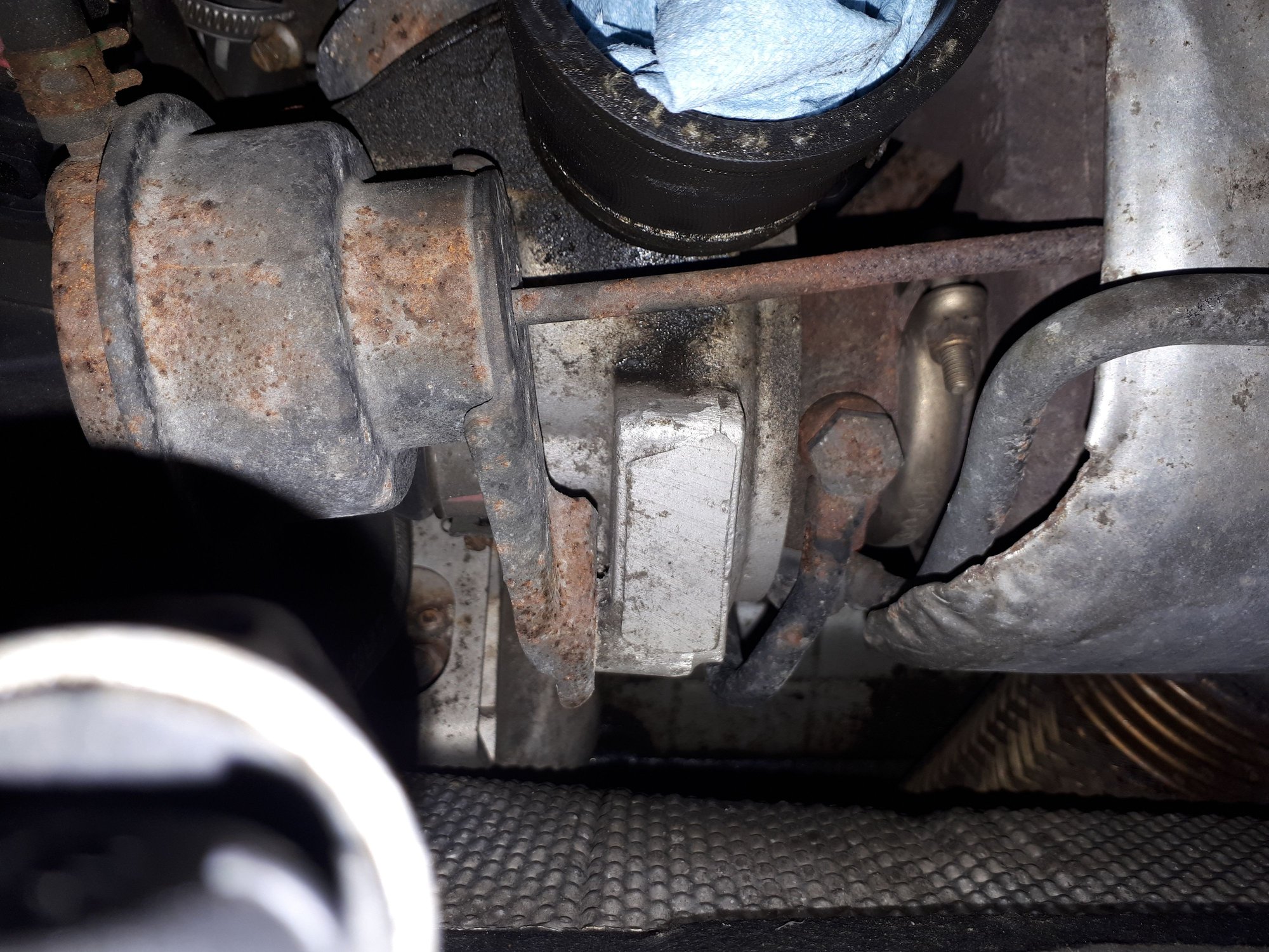

I included the oil coming up in the turbo coupler into the charge air pipe because I figured this might be the cause of the throttle possibly being gunked up..at least, not helping matters.. anyone know why oil is coming up from the turbo into the charge air pipe??

not sure about the fuel pressure damper - I'd trace the fuel line from the firewall (it was under the intake manifold on my 850 and my S40 has the FPR on the end of the fuel rail). If you are getting oil into your intake air pipe - it could be coming from the PCV system or you have a turbo oil seal issue (the bearing shaft is lubricated by engine oil and when the seals go, oil can find its way into the intake air or the exhaust. Did you pop off the air tube right at the turbo to see if the turbo looks clean or oily? Not sure what you mean by "turbo being gunked up". If the turbo itself is full of crud, its time to rebuild or replace.
