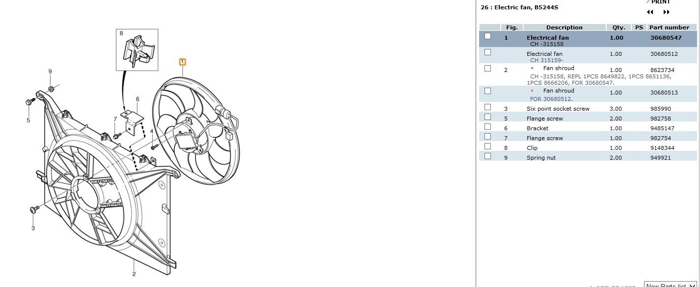

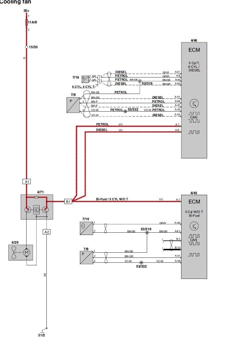

Usually the fan controller causes that - It's part of the fan assembly - on the wiring diagram 4/71 is the controller, 6/29 is the fan motor. The controller get a signal from the Engine control module to turn the fan on, it has 2 or 3 speeds. It's possible someone sells it by itself - Volvo does not.
