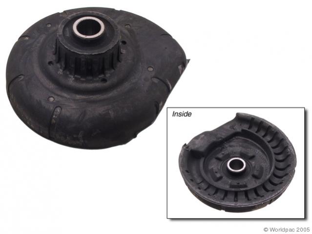

A common problem on the S60, is the Strut Mount bushing going bad, then you will get a squeaking rubber sound going over soft bumps.
What happens is the bushing in the middle separates from the rubber, and then it will be able to move separate from the rubber when your suspension is going up and down.
Attached Thumbnails Bed Springs Sound comming from the front, what is it?-l3031104479sac.jpg
