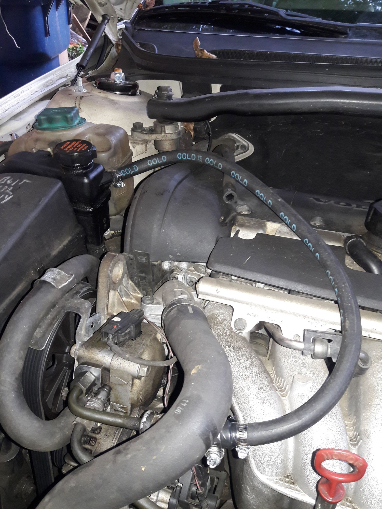

Old Aug 27, 2022 | 11:05 PM
yabadabadoo1026's Avatar
Joined: Feb 2018
Posts: 25
I did it. Bought a used pump that had been cut off and with a hose joiner joined a washing machine water supply hose to it with screw clamps--------------I'm hopeful-- and no reason it shouldnt be-- this is the end of my ruining pumps cause i cant keep fluid in cause of leaky rack. Got a year our of 1 pump that went dry and 3 weeks out of the last one.--not putting a new rack in a 20 year old car. I have been driving it a long time with no power steering and hasnt been bad at all when moving, only an issue parking but certainly quite doable.
