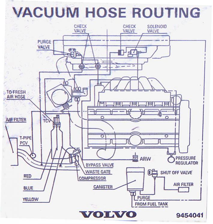

Went out side today to start replacing some of the easier to access vac lines. while attempting to remove the line that connects to the intake hose which connects from the mass air flow sensor I ripped the line completely and now i can not for the life of me find where it connects to. if anyone could please post a picture of where the line connects to or tell me I WOULD REALLY APPRECIATE IT!!!!!!!
by the way its a 98 s70 t5.
thank you!!

did you trace using the vacuum diagram - ie on firewall or the underside of the hood or cowling? Should look something like this
Broke vac line cant find where it connects to. HELP PLEASE-850-s70-vacuum-hose-routing.jpg

I tried to do that but couldn't trace it. The diagram is a little confusing to look at:P Does this include all vacuum line? i'd assume so , but just making sure before I rely solely on this
I'm getting ramps today so I will look underneath the car around the turbo area. With how easy the line tore I'm guessing it was severely damaged to begin. If thats the case it would explain the rough idle!

Now that I had a moment to research more in depth, I believe the line is a very long one which runs all the way across the car, underneath the fuel rail, and then to the distributor cap. If this sound accurate please let me know before i start taking **** apart lol.
