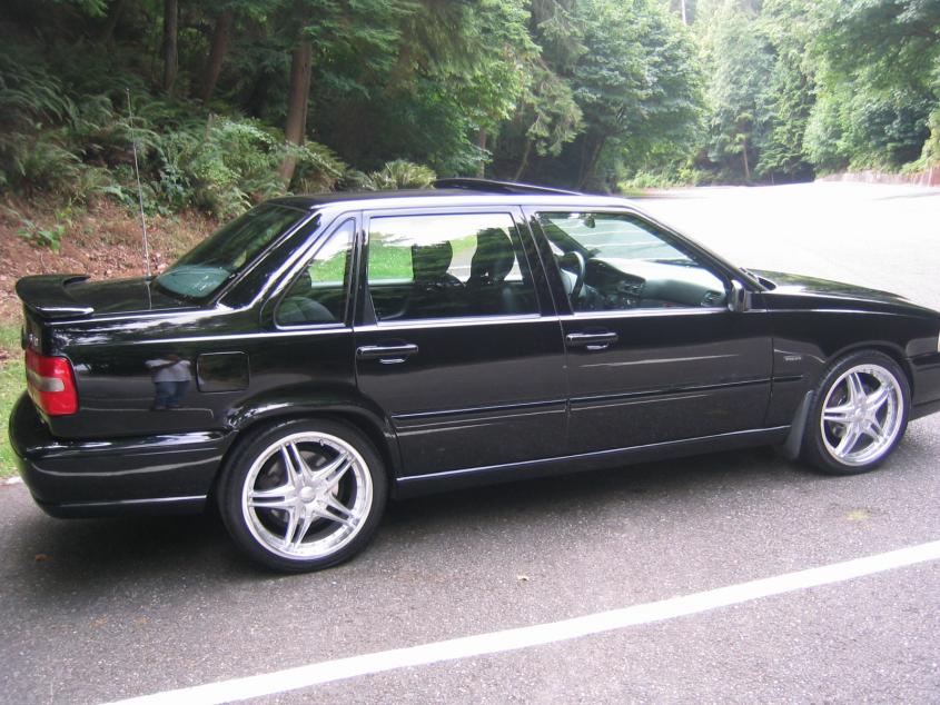

Yea I hear you there, it's not my daily driver so I'm not to worried about it now, oh one other thing is the noise almost completly goes away if I have a heavy passenger as well and it is not the subframe mounts. I'm actually waiting for something to break to find out what it is. Here's a pic of my S70 T-5, Bought it new in 1998 and have owned it since.
