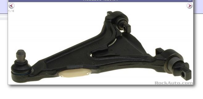

The language above is pretty awful for clarity. There is a sort of anvil on the lower control arm. It's not unusual for this to be covered by a low-friction surface like a plastic block. Maybe it's teflon, I don't know. The teflon block might have fallen off, but look to see where it was. Some manufacturers don't cover that with anything. There is a very obvious part of the steering knuckle which is designed to hit this block like a hammer when you steer as sharp as you can. You can't miss it.
Pictures of the control arm would be readily available at a parts retailer. They don't all have this white spot, but that's the spot.
