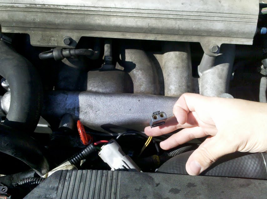

Today I noticed this when I decided to see whats wrong. I hooked up battery to the fan and it does work good, its just not turning on I believe. I took off the small cover that holds the 35amp fuses (which look good) and noticed this plug(below) not conncected to anything where does it go? I cant find it. Is this the problem possibly? Any ideas of what my problem is?

As for the plug, it looks pretty clean compared to the rest of the stuff near it so it was likely plugged into something. I do not have our S70 here so I can't tell you right off, however, are all of the fan wires connected? Even the ground?

Look to where your thumb is in that picture, is should plug back in there.. let me know if you cant find it and ill upload a pic
Yeah, cant find it could you please post it?

http://img820.imageshack.us/img820/1...0926145146.jpg

Alright! Thanks man. I really appreciate it.
I feel stupid for not seeing that lol.
