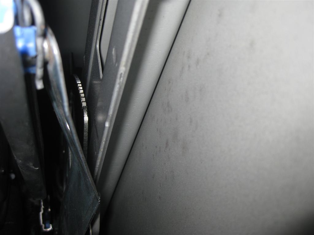

On the driver's side door, the regulator arm closest to the hinge of the door, appears to be bent. It has about a 15-20 degree bend to it. I can't tell if I've somehow damaged the regulator or if it is designed that way. I REALLY don't want to have to remove the damn regulator just to bend that arm back. I wish I could post a pic but there's no way to get a camera in there.

Ok, Wow... so after finally getting a camera in there, That is DEFINITELY not the way it is supposed to be....
I have a question about the rivets though. I've got no problem drilling out the rivets, but I've never used a riveter successfully. I just don't know what the heck I'm doing.

Here's the pics...

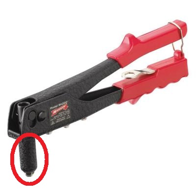

The arm is definitely bent. You can try to bend it back in place, put in the new sliders and see how long it will last. Make sure you lube up the slider track and window tracks (front and rear) so it doesn't happen again. If you drill out the rivets to remove the regulator, you will need a long-nose pop riveter to put it back. You can get one online (Amazon), or I think Harbor Freight has one that might work.

Here's the rivet gun I'm talking about.
Would this be doable? I mean, the tutorial on matthew's site says to use a 3"... I don't know what part is supposed to be 3"

The nose (circeld in red) needs to be 3" long to install the rivet in the back.

There is no way I can bend that arm back while the regulator is in the window. I need to take the regulator out and hammer it flat.
I've searched google and can't find anything that's a long nose rivet gun, or 3 inch rivet gun.
I did find one on amazon that's $154 dollars....
