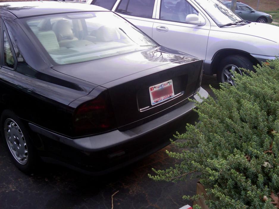

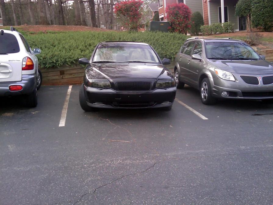

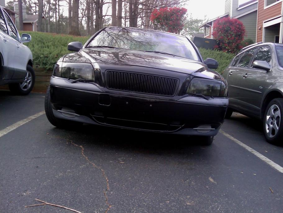

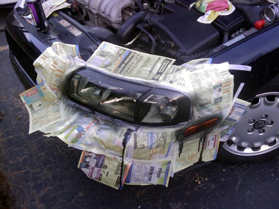

As promised here's pics of my headlight tint and de-badging...
I really like where this is going
Sorry for the crappy pics... cellphone is the only camera I have at the moment. The rears are actually much darker and almost completely black... the sun was hitting them at an angle so it was glowing a little red.
I did notice a small difference in headlight brightness but not a whole lot. The lights were VERY bright to begin with (Sylvania ultra pure whites or whatever) and even though they are properly aligned, I still was flashed often. 5K HIDs should fix whatever bit of a dimming issue I have.
The trim dye should be here this week, and HOPEFULLY I can get my window tint done sometime in April. $$$'s tight ya know.
I can't wait to get these god awful wheels off this car.

I like the rear tint. How'd you do it?

I live in South Raleigh (NCSU Area) and work in Cary
I bought the VHT Spray on Window Tint from Summit Racing. (NOT Nightshades... which is the actual light tint)
I just taped everything off, then masked with paper, and sprayed, and sprayed and sprayed. The stuff is supposed to be sprayed on very thick and allowed to "run" down the light.
I did not tape off my bumpers enough because it ran through the paper. Now yes it was only phone book paper but its 5 sheets thick everywhere and that wasnt enough. I would suggest using wax paper... And make sure if you are doing it in your drive way you have something on the ground because the stuff runs really bad... and you have to spray it on THICK.
Now my headlights have some streaking but I don't want to put another coat on it so I'm just going to live with it for now.
