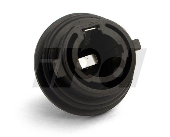

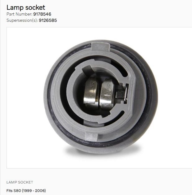

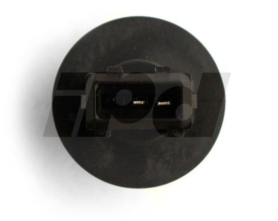

What bulb holder do you have? Grey 3 conductor for a 1157 twin filament bulb, or a black 2 conductor for a 1156 single filament bulb? Are you certain you are using the correct bulb for the correct socket?
If you have a grey 3 conductor socket and jam a 1156 single filament bulb in it - the two conductors for park and turn signals will touch - and cause the turn signals on that side to stay on (if your parking lights are on all the time due to your daytime running lamp settings) Or I have seen 1157 twin filament bulbs with the solder connections touching each other and cause the same (T/S on all the time)

So I recently did the taillights and was confusing my bulbs for a second. I have a grey conductor for for the twin filament but when I was looking up bulbs at my local auto store, it recommended 7507 bulb, which is what I have in the back for taillights and they work just fine. But I can see now the 1157 and 7507 are completely different. I’ll have to go buy some 1157 and see if it fixes the issue. I see on the Volvo website it calls for the 1157 but on sites like O’Reilly it says that isn’t a fit for my Volvo. We’ll see. Thank you for the bulb breakdown, it helped me realize I may in fact not have the correct bulb in.
