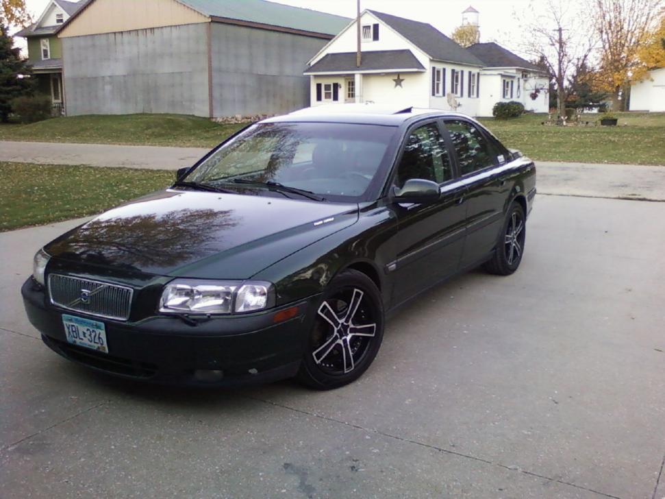

I got a 99 S80 T6 and once im doin about 50+ mph and accelerate slowly up to 60-65 in shakes terribly but goes away if i let off the gas. it also shakes by just hitting a little bump in the road and is terrible on rough roads. could this be a CV shaft, tie rod, sway bar, etc. i just replaced a bad a wheel hub so i know that wasn't the issue
