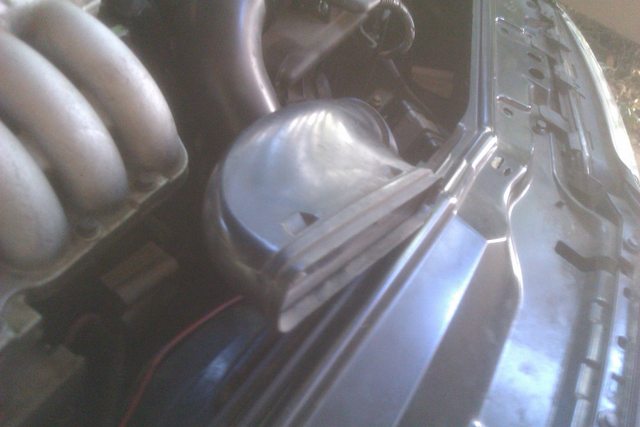

Why won't this hose go back on?
Just bought a 1999 S80 2.6 last weekend. It's my first car and I bought it relatively impulsively, but I've been looking for one for a long time that isn't a salvage title and it was a great price.
Anyway, I bought it from a private party knowing it needed a little work before it could smog (I'm in California by the way). He said it needs a new oxygen sensor (the check engine light is on). It has had a front-end collision, but the damage is pretty minor (didn't break a headlight, smashed some of the plastic parts, hood doesn't quite sit flush). He actually couldn't get the hood open, but I got it open without too much effort, so whatever. Anyway, this hose (sorry, I don't know what it's called but it goes to the air cleaner) is disconnected, and I can't see how it would fit back on. The part that it would connect to seems almost shifted over at least a couple inches, but the front end is not that out of whack.
That said, is it wishful thinking that this could be the issue and not the oxygen sensor? Even if it's not the only issue, I would still like to see it fixed. I talked to my mom on the phone and she said she had basically the same issue with her 850 and that the guys at the shop just taped it on.

If it doesn't line up, something has shifted, simple as that. So you need to find out why. My S80 doesn't have the same intake as your car, so I cannot help much further, but in short there is no reason it shouldn't fit back in place except if something shifted.
That pipe should fit onto the airbox and slide on by about two inches, then the front part matches up with a corresponding hole behind the grille. If the pipe is misaliged with the hole and its already stilling correctly it may just be that the airbox isnt sitting where it should. It sits on rubber grommets and can move sometimes.

It is simply a cold air duct. Look under the header panel and you'll see where it connects. The outer edges get chewed up from people trying to jamb them in there. Take your time and snap it in place, then connect to air cleaner box. Done.
I had problems putting mine back on after I took out the air filter box so I pulled out the opposite end and removed it. The car runs fine without it.
It is the cold air intake. Instead of pulling in cold air from in front of the radiator you will pull in slightly warmer air from rear of the radiator if you remove it.

Regarding the hose question. I haven't tried disconnecting it from the air cleaner, hooking it up in front, then back into the air cleaner. That seems like it could work. I'll give it a shot when I get some time.

I had the same problem with that plastic piece. I think you will find installing it up top first and to the airbox second may solve your problem.
