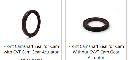

Hello everyone, my car's camshaft seal is leaking oil. However, finding the proper one is a little difficult for me. Since One has a CVVT Cam Gear Actuator, the other does not. My car is the 2000 v40 1.9t. How am I supposed to know which one to get?
The image below is only an indication of the location. This isn't from my vehicle.

If a front cam seal is leaking you should replace both. A common thing that causes the seals to leak is too much crankcase pressure due to a clogged or partially clogged PCV system. So new seals will be a temporary fix if the PCV is a problem. Keep in mind that on the sv40 1.9 4 cylinder of that vintage - the VVT pulleys leak oil and it's almost impossible to tell if the seal is leaking or it's the gear. A new gear is the solution, preferably before the new cam belt is damaged from oil continuing to leak from the VVT after you have replaced the front seals! The 5 and 6 cylinder VVTs seem to rarely leak - but it is common with the 4 cylinder engines.
Old Mar 29, 2022 | 08:41 AM
Likes: 540
+1. Keep in mind that the work requires the removal of the timing belt so with that out of the way, its a good time to replace the belt/tensioner unless they are recent, any suspect seals, inspect the water pump/crank seal, and the gear. If I recall correctly, the shop time for replacing the timing belt itself is something like 2 1/2 hours give or take, and doing the seals and gear is a minor add-on not counting part costs. Do this right and you should be good for another 10 years/120K miles.
