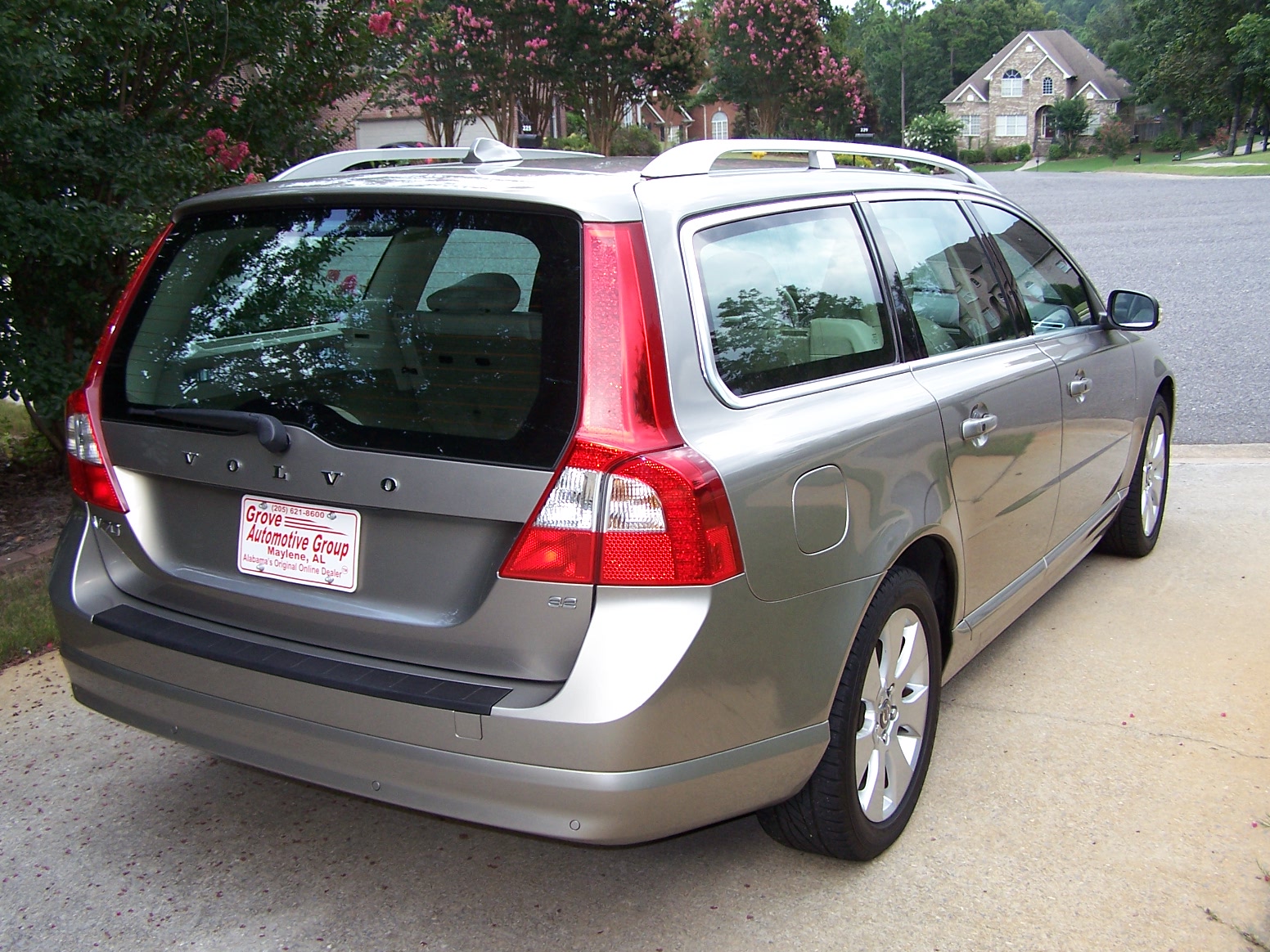

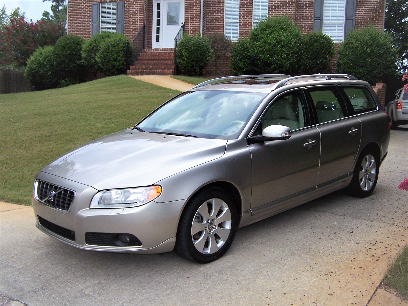

In my opinion, its a piece of junk. Of course, I'm a dealer here in Alabama so my view of vehicles is different. I would pass.
Attached Thumbnails Hi and seeking knowledge-100_4489.jpg   Hi and seeking knowledge-100_4490.jpg   Hi and seeking knowledge-100_4491.jpg   Hi and seeking knowledge-100_4492.jpg   Hi and seeking knowledge-100_4493.jpg
