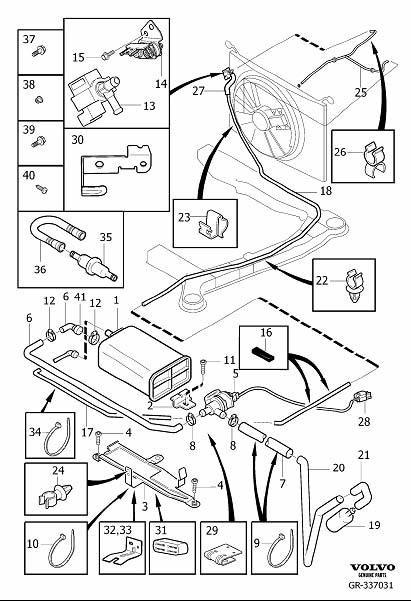

I'm using this diagram to try and locate the purge valve, but I can't really tell what part of the car I'm looking at.
Old Feb 8, 2021 | 08:53 AM
The valve is #13 mounted near the left corner of the fan shroud
I gathered that much. The fan shroud is the radiator far? So this would be front left of engine?
Old Feb 8, 2021 | 08:53 PM
yep, the drivers side
