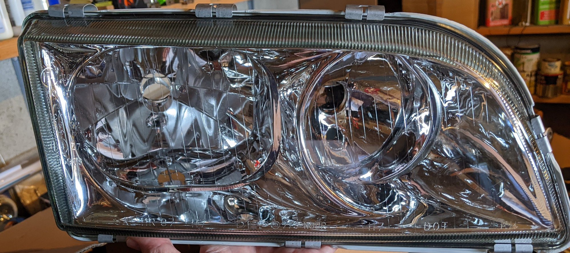

I bought some DEPO C70 glass lensed replacement Jewel lights for it to complete the update I already had the new corner lights to install.

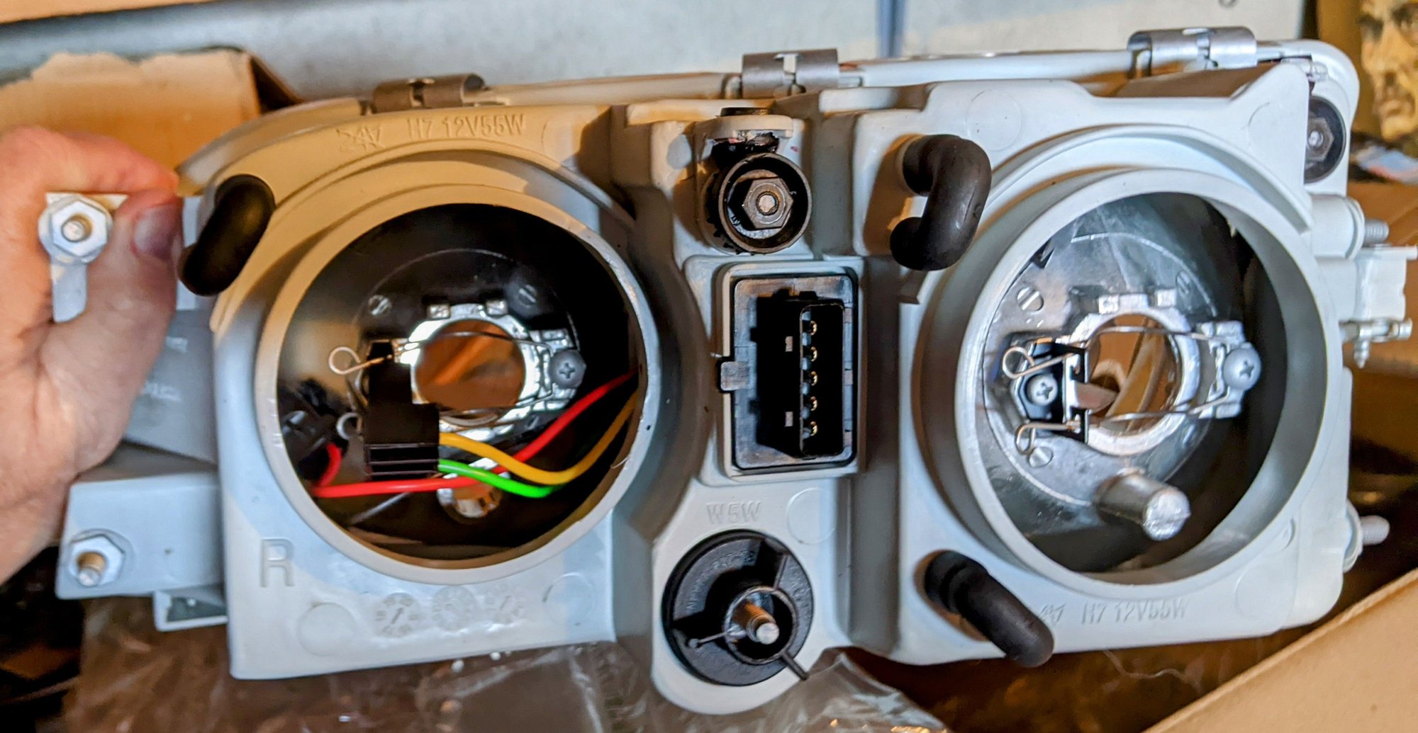

But the shop says they won't fit in the R. They have different backs and a five pin plug vs. three pin on the R, along with a 5 watt bulb location under the high beams.
I already have a set of H7 bulbs to replace the H1's from the R.
Is there something I'm missing? Do these fit? Will they work with the wiring harness I have? Do I just need to change the attachment plug from 3 pin to five pin.

This mod never occurred to me, but I'm interested. I might like to do this on mine too. I am not familiar with DEPO; have TYC lamps on my car now.
The V70 headlamps have 3 wires. There's power to the low beam, power to the high beam, and ground. That's all you need.
So on the C70 headlamp, you need to figure out what all is required to make it work, and my guess would be it'll just work with physically compatible plugs after you abandon that extra bulb. The way those are made, you can just look inside and see which wire goes where.
I'll see if I have a wiring diagram that explains it and then check back.

Nice of you to check in. I had further discussions with my mechanic and they indicate that the mounting bolts and positions for the C 70 DEPO Jewel lights don't fit and or match up with on the V70R. So no go. These guys are pretty enterprising so I tend to believe them.

Well, I might need to read some long project threads where cars have this mod. Looking at your pics, I do see where the attachments are not at all similar. Hmm. I guess that tells us the C70 has a unique rad support.

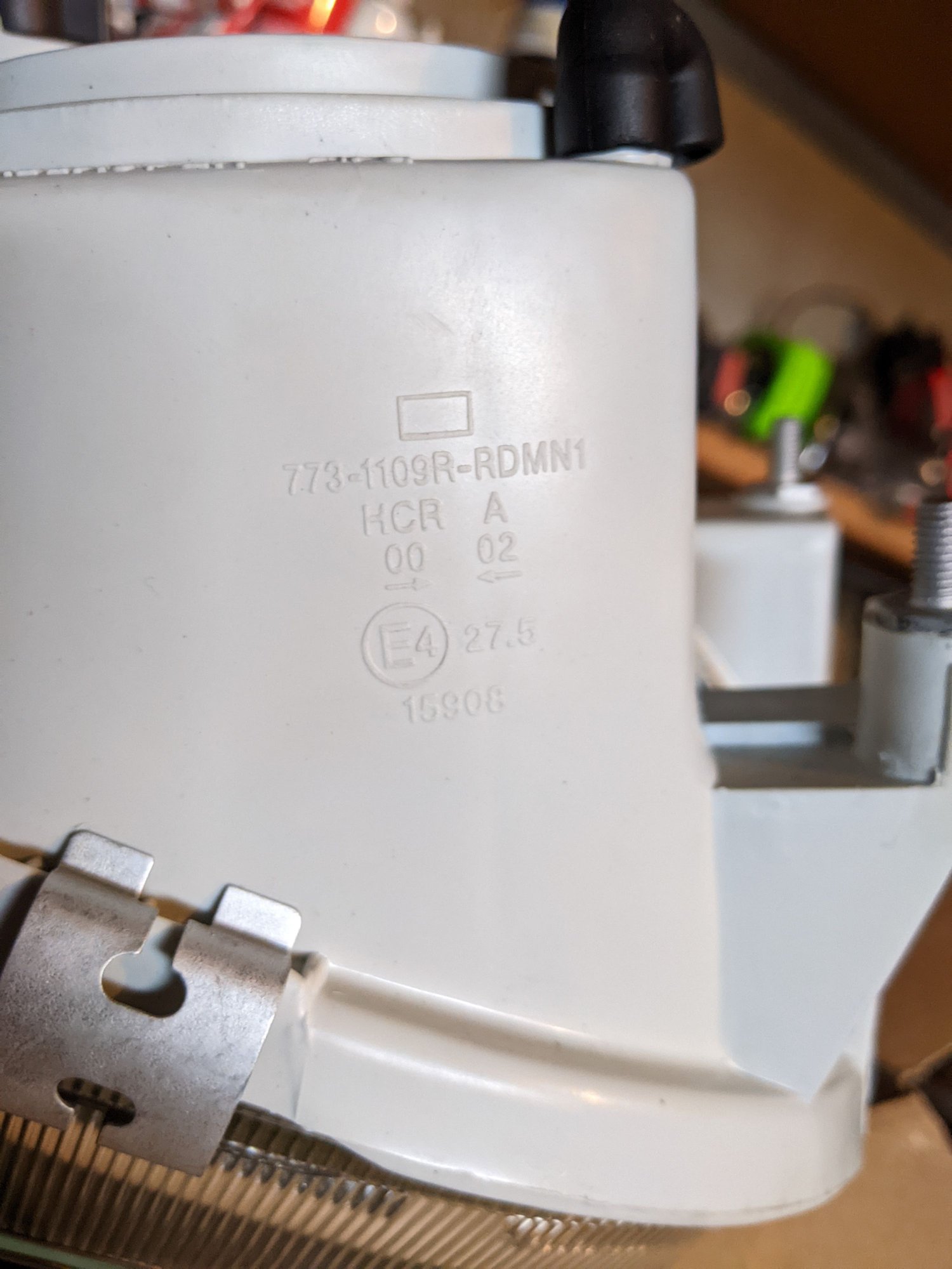

It looks like you have been shipped headlights from a 2000 - 2004 Volvo V40. These are similar in shape to the Jewel headlights from a 2003 - 2004 C70, but they won't physically fit. If it isn't too late, I would ship them back for a refund, and tell them that they sent the wrong lights. Don't let this deter you from the Jewels conversion, actual Jewels from a C70 should bolt right on to the factory core support. I knew something was off when I saw that this takes H7 bulbs, Jewels take H11 bulbs for the low beams, and 9005 bulbs for the high beams. Also, as far as I know, there is no P80 chassis Volvo that uses a 5 pin connector for the headlights. The connector will usually be a 3 pin, with space for a 4th pin.

Yes I'm afraid that I agree with you, wrong lights, doubt I will get a refund but will try.
That is good news about the 3 pin connectors being the same on the V70 and C70. Was afraid I was going to have to rewire the connectors to make a 5 pin work.
