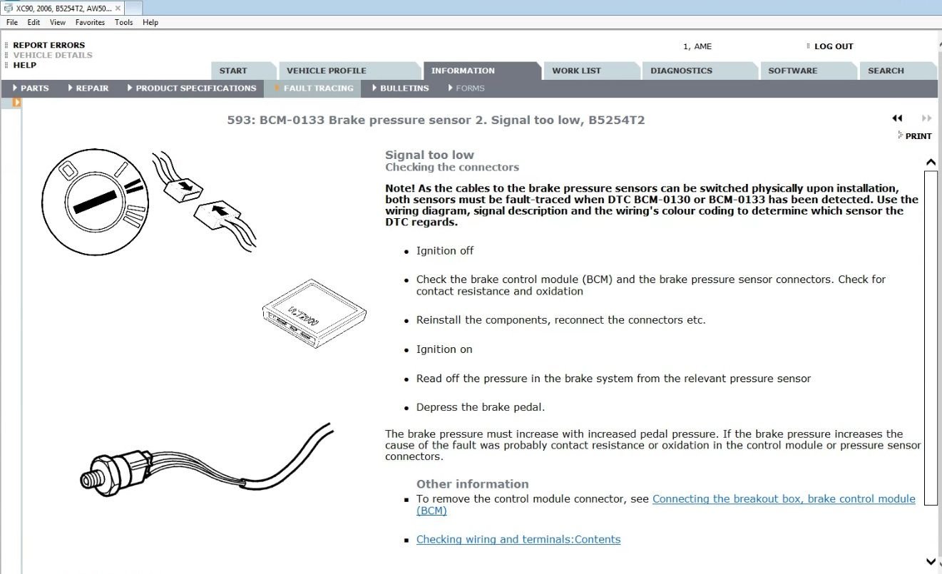

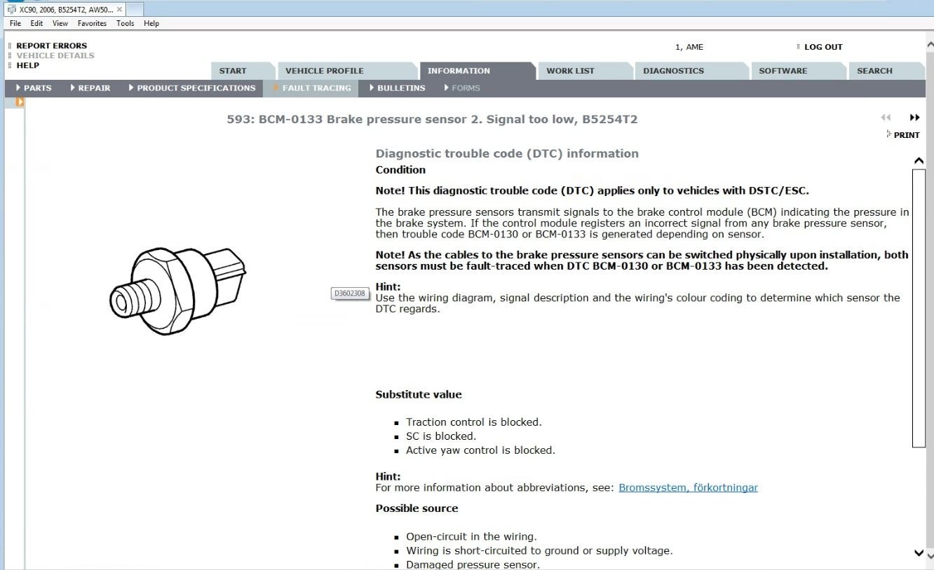

One of the best things about VIDA is if you click on the code you will get suggestions as to what the problem might be. Hopefully you have seen the screen shots below. You can actually test the pressure sensors to see if they are sending a signal to the ABS module. You have about 4 choices - the last is a problem with the ABS module. So go thru what Vida suggests (DON"T buy any other parts to simply swap not knowing if that's the problem) and possibly if you can't find a problem - there may be an internal problem in the control unit. A company such as xemodex can test and repair yours.

Thanks for the reply Hoonk! Do they make one of them VIDA for Dummies books?!?! This system does way more than I know how to make it do. I have seen those screenshots but I think I moved away from them because of the reference to a "Break out box" and "wiring diagrams" both of which leave me out in left field with a football bat! I will get out to the car in a little bit and run the diagnostics again.
