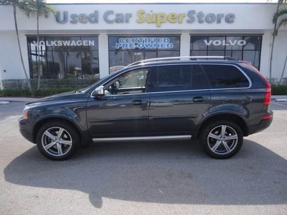

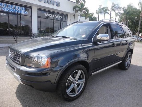

I decided months ago that a XC90 was the best bang for my family's buck and have been impatiently waiting for the right one to show up for sale. Finally, a week ago I found it. 2011 3.2 R Design with RSE. BLIS, NAV, Prem Audio (so disappointing they dropped Dynaudio for 2011) and a bunch of other goodies. Finding an xc90 optioned out is not an easy task! This is a CPO and Volvo's CPO program was really what always redirected me back to them. The car is under bumper to bumper until 2/2018.
