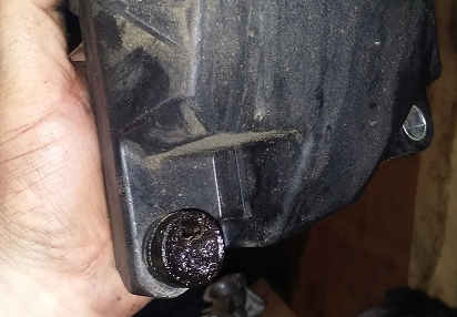

My primary concern when I started this project was the PVC system. If the Crankcase can not breath right, then when the turbo kicks in, it has to draw air from somewhere. So if it can not get air from the primary means, it will either blow air into the crankcase and over pressurize all the seals. Easiest seals for it to get what it wants is your Cam seals, and the Main output seal. If it does not get fixed by that time, it is going to total it self. (I don't know what really is, but it is bad, and expensive).
Note: the worse case I seen on the internet, included that the oil pan had blocked passages (for my car) I had that as well, and if nothing else, it learned if I am going to do something, I did everything at least twice.
The person that helped me the most was a Parts guy. He had the similar car as this one.
Step one for me, (since I am a EMT in previous time in my life) Breathing. I took off the PCV (Crankcase Ventilation) Looks Like I used the wrong acronym in my header title.

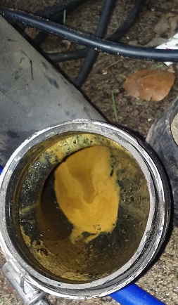

Step two, when taking apart the turbo charged air pipe, and the intercooler, is when I found the next issues. I didn't see my pic that I took of the connector pipe from the harden tube, to rubber tube, to the intercooler. That last tube, I was concerned about prior to my PCV journey because it alot of built up oil on it. It did not come off readily. I was assuming maybe power steering pump issues, or something else. (I had no Idea). My first clue was weird yellow mix under my thottle body.

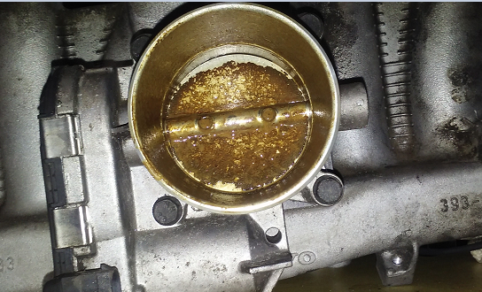

For me it became obvious that the turbo was blowing oil/coolant mixture down the charged air tube. Which eventually covered my butterfly valve.
Then I started thinking, if its really crappy on the down slope to the intercooler, and the tube from the intercooler to the ETM (throttle Module) butterfly valve is yellow sprayed on, etc... How much crap is in my intercooler? Common sense tells me, if there juice getting though the intercooler, it has to be at least half filled with that crap. (no pics)

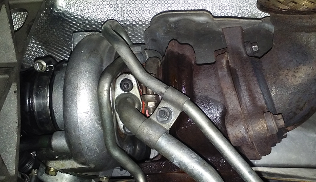

Up until this point I had not thought of the Turbo as an culprit. When I got the car put back together, and getting ready to get it running, (it was a project that I could only afford one day of the week, and that was only half a day usually. So since my car had been sitting for soo long, I decided to put seafoam into the intake portion of the engine, and then as I got closer to lets start her up, I put oil into the sparkplug holes. (It was winter when I started this project, now it was spring, working outside, next to small garage) So after filling up the various liquid items, a week later, I noticed I had two leaks, one was the thermostat housing, and the other was the turbo.
Since the car had not been running, it didn't dawn to me that the leak was from the sparkplug hole, I was convinced it moving oil, somehow, and it leaked, just because I topped off the oil capacities. Good thing I did, the Turbo shop asked if I tried to move the turbo things. I had no intention of learning another skill, so I just boxed it up, and brought it in. He said the bearings were replaced, he could not get it to spin. and he replaced the seals. Thanks DCI of Burnsville, MN ($520). A local shopped suggested I look up Diesel shops that work on turbos. They would have least issues as far as returning jobs.
