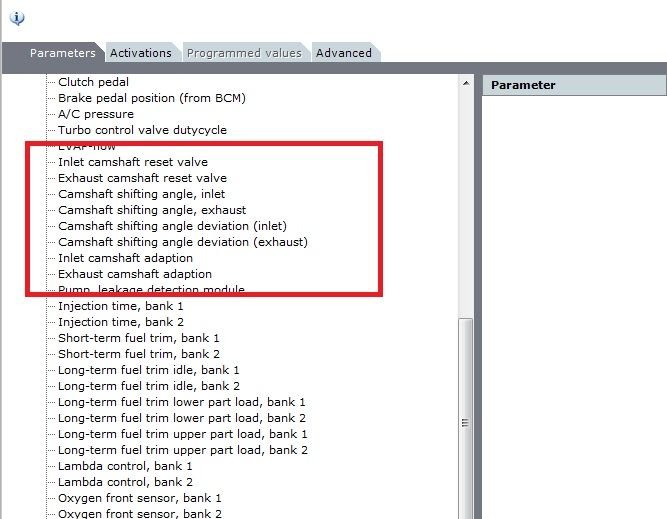

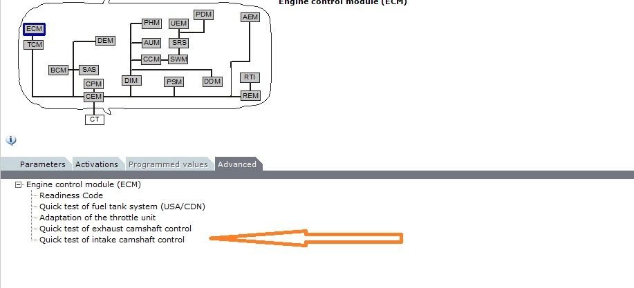

You could purchase a VIDA subscription and (hopefully) compatible DICE unit to be able to check the parameters shown below. Aftermarket scan tools (expensive ones!) will be able to do the same thing.
