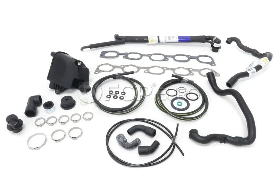

Solution is to remove and clean the oil pan, replace the pickup ube with the new style tube, and replace the PCV system. The pcv parts that are replaced are most of those shown in the following picture. Carefull - half of the low oil pressure pan cleanings I've done were after replacing a bad turbocharger that failed from lack of lubrication. (car arrives smoking so badly you can't drive it, then low oil pressure appears after replacing the turbo)

The oil drain passageway in the block from the bottom of the plastic oil separator pcv box in the picture above gets completely clogged. You have to remove the box and the oil pan to clean that oil drain passageway both in the block and the pan. If you get that far be sure to use the new plastic tulip shaped oil pickup tube instead of reusing the old metal one.
