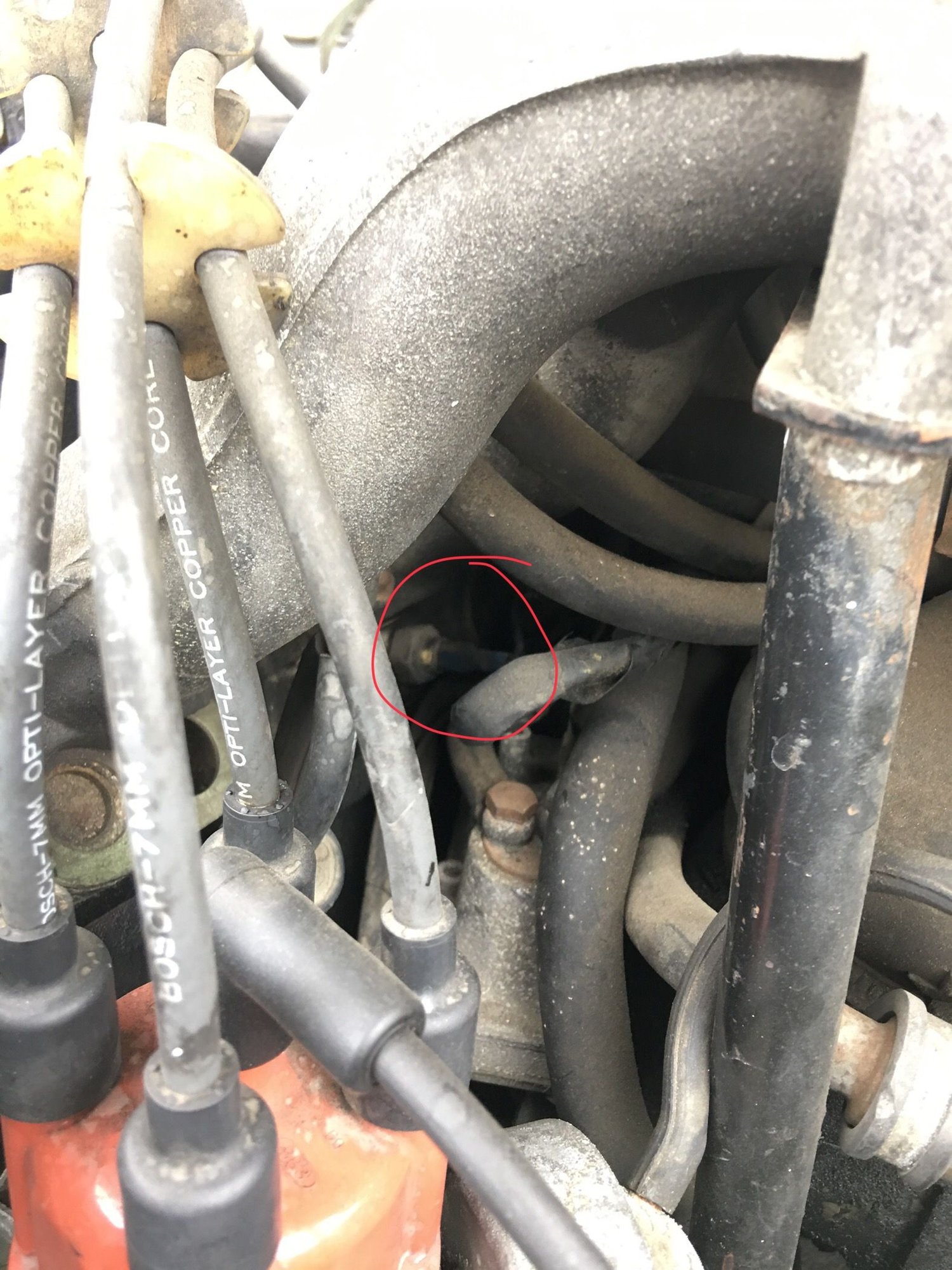

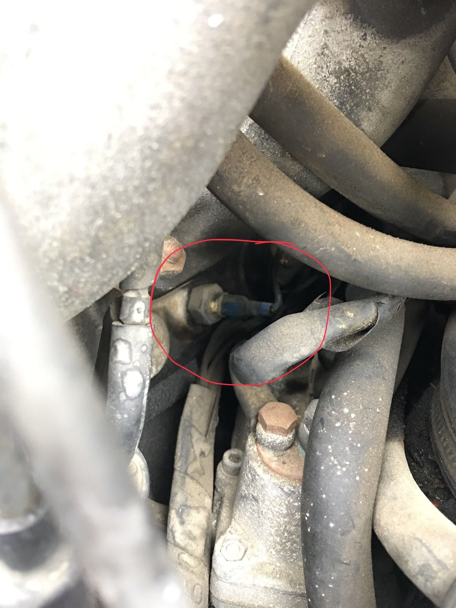

Think I narrowed it down to the coolant temperature sensor..
Just to be sure, this is the CTS right?
[img]blob:https://volvoforums.com/ac769c66-6c9e-445d-98f4-34fcbd0b0c87[img]blob:https://volvoforums.com/cdb87478-166a-4f61-a67f-dbe6338ad55d

Gentlemen. I also have received invaluable advice and guidance from Pierce , Lev, and other enthusiasts for which I am truly grateful. In regards to the photographs provided, is that the CTS he has circled?
