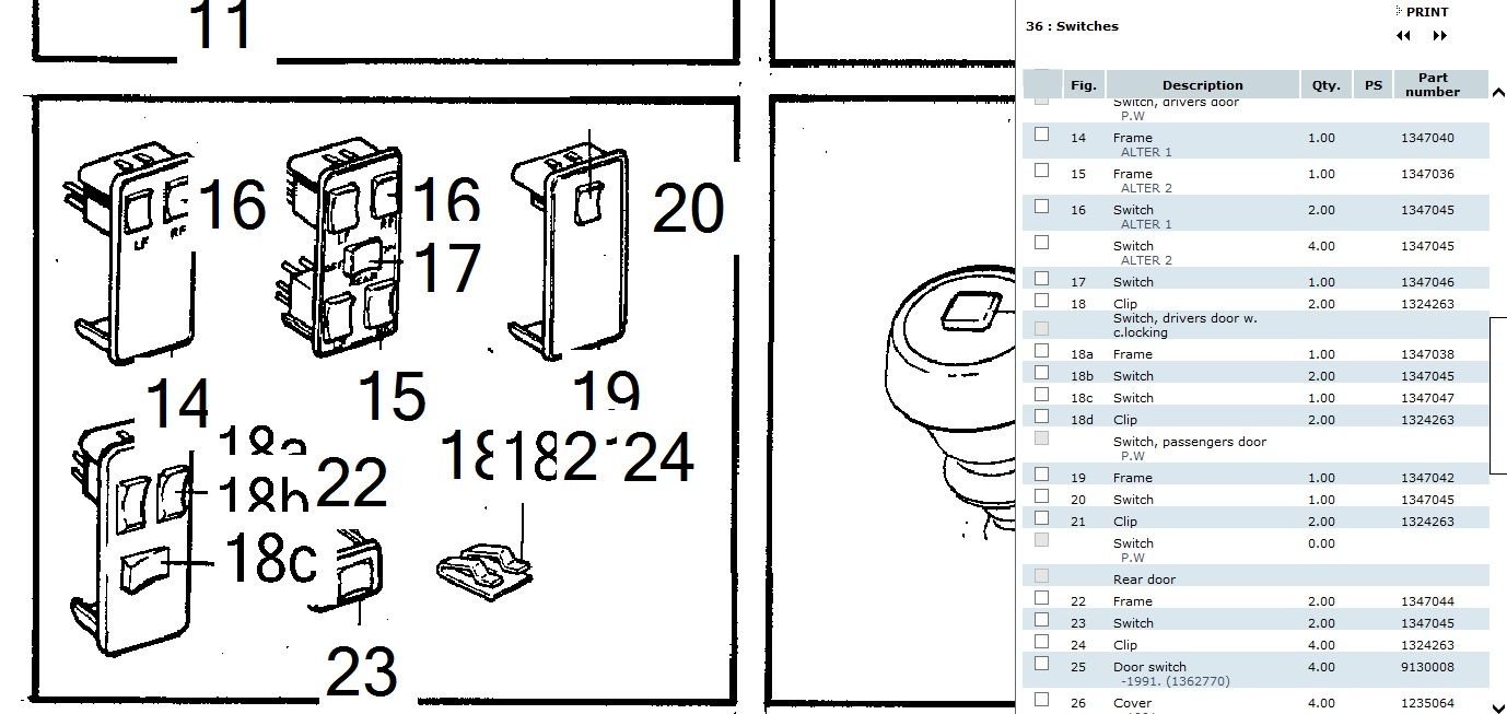

Seeking input on drivers door window switch s, I'm finally getting our family owned since new 240 wagon, back on the road, and was looking to replace very worn electric window door switches. My searches of my two online parts suppliers has left me confused, as their offerings, and related part numbers don't seem to be the same. Not positive about forum rules on supplier names, so I'll leave them off, and show part numbers.
First supplier shows, Volvo OEM part number 1347063
Second supplier , Volvo OEM part number 1347045
Any input is appreciated!
Old Nov 22, 2024 | 05:46 PM
Here's a 240 parts page. The 1347063 fits 700 and 900 series cars. The 1347045 fits 240's

I don't know why I didn't think of it earlier, I'm just in from my garage where I lifted up the switch panel, and got the 1347045 off a current switch.
