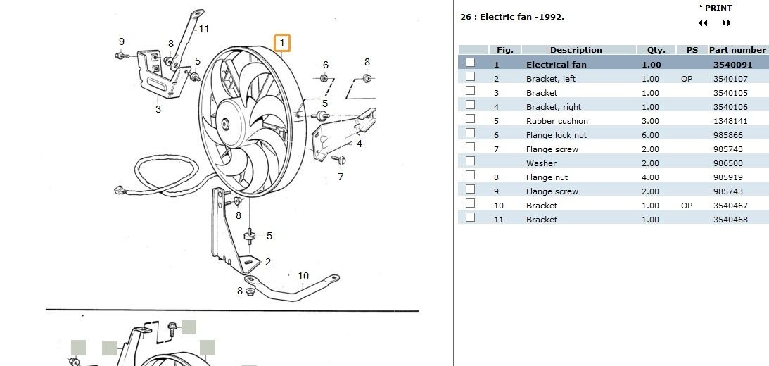

Your car came with an electric fan (pictured below) It probably broke and was removed. The temp gauge on your car is known to not be accurate. The temp compensation board in the instrument cluster is usually the problem. It's designed to artificially make the gauge read lower when the AC is on. The gauge will be inaccurate at other times also. This page has info to remove/bypass it -

I will definitely look into getting a new cooling fan assembly! None of the parts in that picture are present on my car, Only the old school mechanical fan. Where might that relay be located? What does it look like? Standard Bosch-style?
