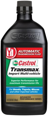

note that you check the transmission fluid level with the engine idling and everything fully warmed up. you add it via the dipstick tube with a special funnel, I use one like this...
make sure the funnel is CLEAN, you don't want to introduce any dirt or dust into your transmission fluid. Use a quality Dexron III ATF, I use Castrol Transmax Import Multivehicle, as these Volvo's have Aisin-Warner (Toyota) transmissions, and that stuff is the optimal spec for them.

i purchased this fluid for my car. is that okay?
Old Jan 18, 2020 | 03:39 PM
I don't see on the label what spec it is. for sure you do NOT want to use LV or VI (6) spec stuff.
