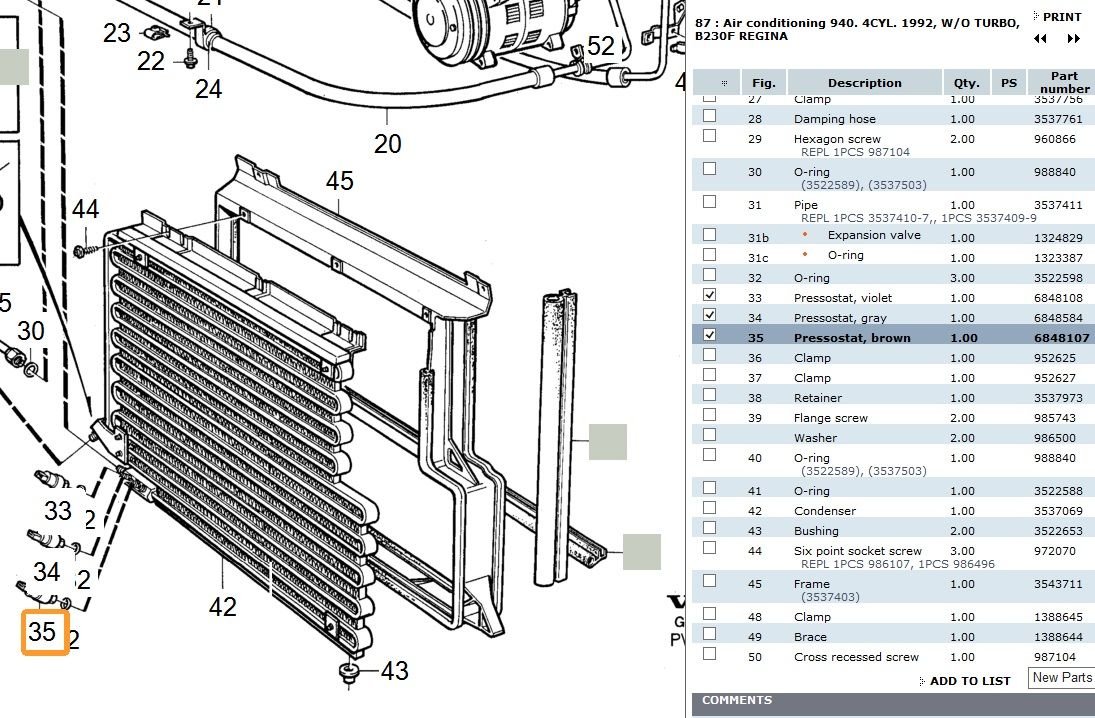

The electric fan as mentioned is turned on by the relay part number you found - It looks like the standard two speed relay used on many Volvos. The AC switch to tell the fan (through the relay) to come on is mounted on the bottom of the condensor. If yours looks like pictured with three switches (33,34,35)- one is low pressure compressor shut off, one is high pressure compressor shut off and the other is to turn on the fan when the pressure is high enough. Sorry can't tell you which one is the fan switch, I don't have a wiring diagram for that year. Looking at the relay - 30 is B+, 1 and 2 are the two fan speeds. The two round connectors are for the signal wires to tell the relay to turn on - I'm certain you have found many of those round terminals with melted/destroyed rubber insulation on your car so far - there is a website "prancingmoose.com" where I have seen replacement pigails to fix those melted round connectors.

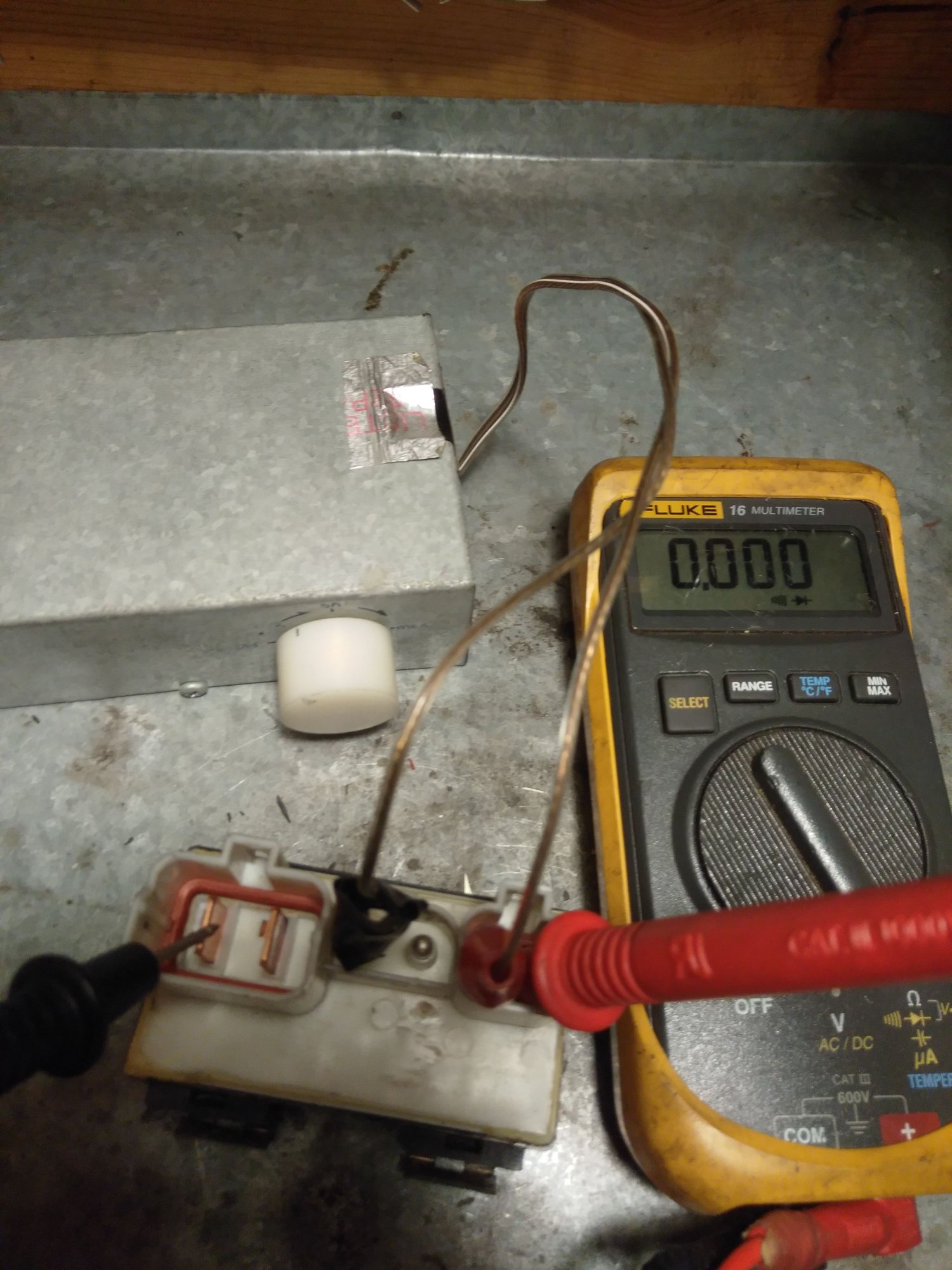

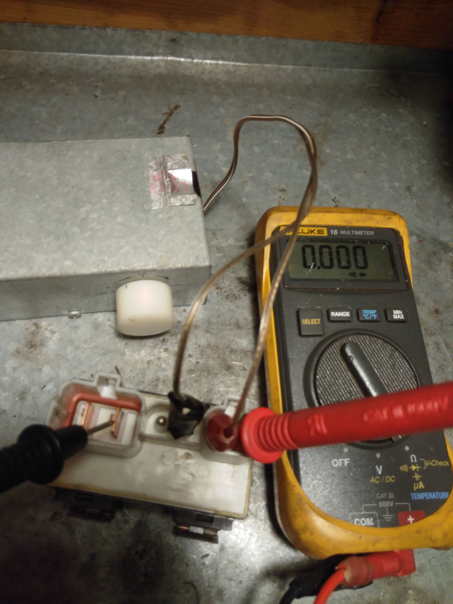

Thank you lev and hoonk you rock!! I checked the cooling fan relay (as shown below) by connecting 12V (+) to terminal 30 and (-) to terminal In 1 then I have continuity from terminal 30 to terminal out 1. When I switched (-) to In 2 I got continuity from 30 to out 2 which means the cooling fan relay is working. save $78 for the new relay.

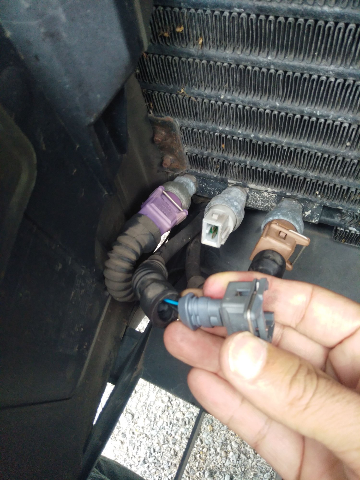

The next test I plan to do is to find which pressostat is to turn on the fan. Since my AC is working properly and the compressor is cycling on and off, I am going to unplug one pressostat at a time and leave two others plug in. My theory is that in order for compressor to work both high and low pressure sensors should be closed for electricity to run to the compressor.
  1. If I unplug the high pressure sensor, the compressor will not run when AC is on
  2. If I unplug the low pressure sensor, the compressor will not run when AC is on
  3. If I unplug the fan switch, the compressor will run as usual when AC is on
  4. If I jump the fan switch, hopefully the cooling fan will turn on ( when pressure is high the switch will closed (negative trigger) for cooling fan to turn)

hoonk, Great advise and chart. I am able to follow your advise to work on my 30 years old Volvo

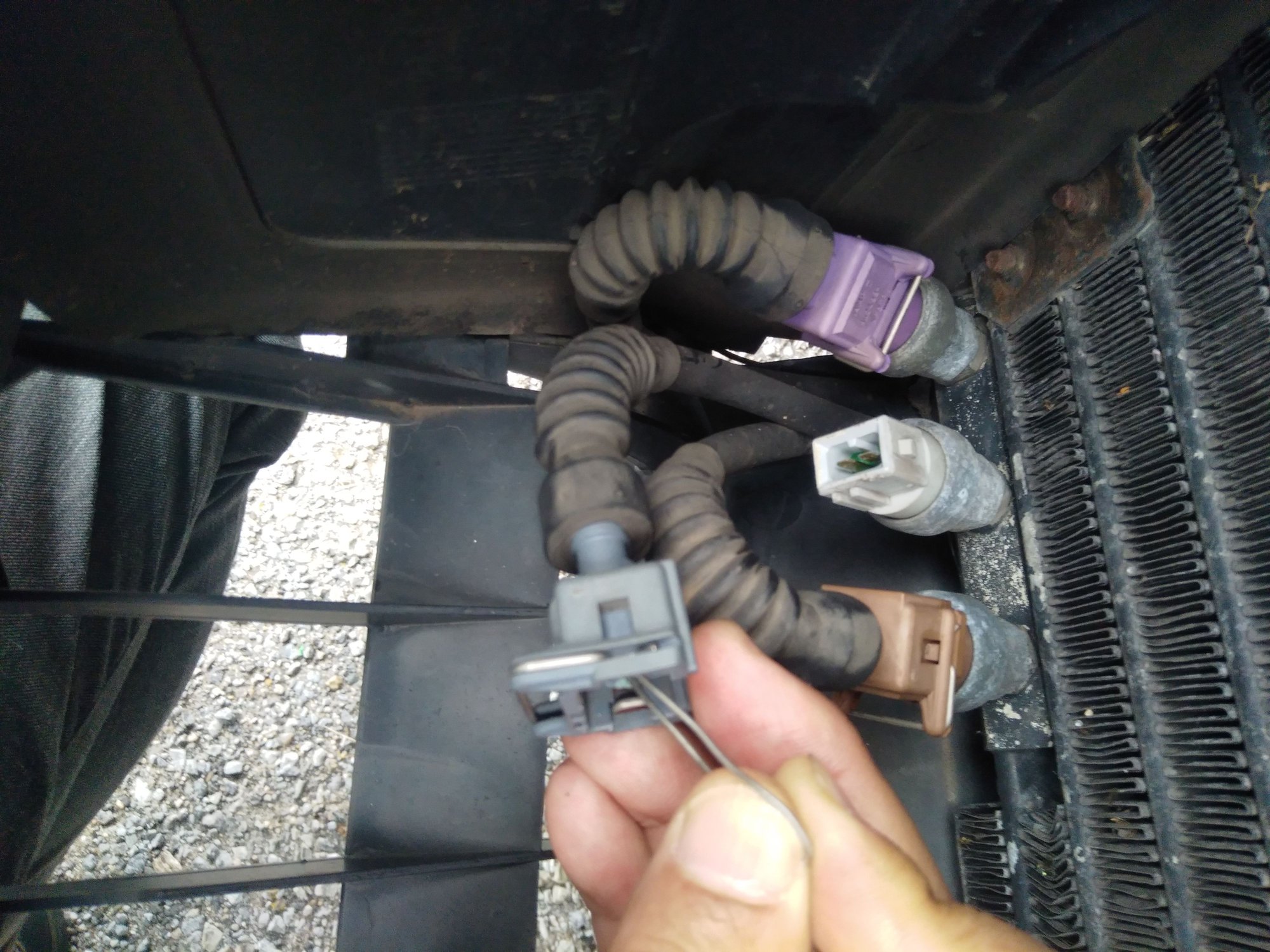

Today I found the gray pressostat #6848584 is the pressure switch to turn engine cooling fan on when the condenser pressure is high. I jumped the socket (image below) and the fan turned. The blue/black wire from the gray pressostat connected to cooling fan relay "In 1" which is low speed fan (see image below). I am glad I figure it out through you guidance. I hope other people who can also benefit from the post. Thank you!!
gray pressostat #6848584 is the pressure switch to turn engine cooling fan:
Blue/Black wire to relay "in 1" low speed:
