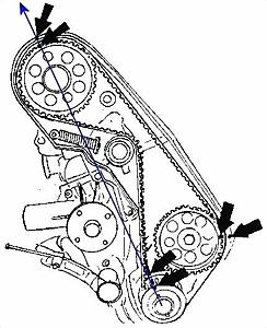

check your timing belt to be sure all three shafts (crank, cam, and intermediate) are properly aligned when its at TDC.

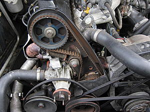

the timing belt is behind that black plastic cover on the front of the engine.
you should be able to see the marks by just taking the upper cover off and peering down into the crank pulley with a small bright flashlight...
