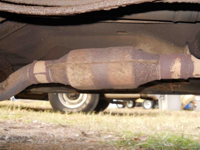

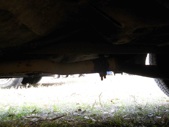

The exhaust was just hanging at the first muffler. Cancer on the pipe welded to the cat caused it to separate from the first muffler. The rest of the exhaust is fairly rusted and the first muffler is loose & sliding on the pipe. I ended up removing everything from the cat pipe back. Obnoxiously loud for the time being. I'm considering ordering the complete replacement exhaust from IPD for $160+$40Sh. Or, just the first muffler $53 plus some creative welding (which I would be paying to have done). I'm not sure if the cat is Ok. Any advice on the exhaust? There is also banging over bumps, like the exhaust banging around. I think it's time for Engine Mounts from IPD. Shop neighbor mechanic wants to charge me $50 to change both out with my mounts.

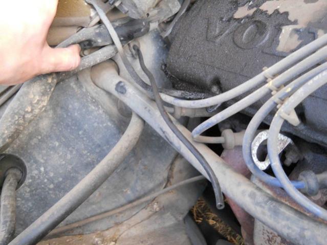

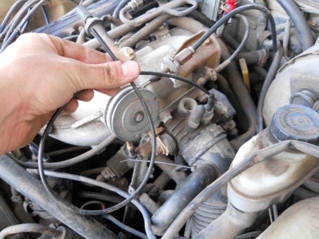

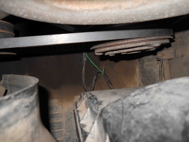

There are many rubber lines and electrical connectors not connected or broken. Some are detailed in the pictures included in this post. My garage has other pictures of the car.

The hard broken vacuum line goes to the ignition control unit on the windsheild washer fluid container. The disconnected vacuum hose is for your vent controls (attached to the intake manifold). That green wire is part of the A/C controls.
