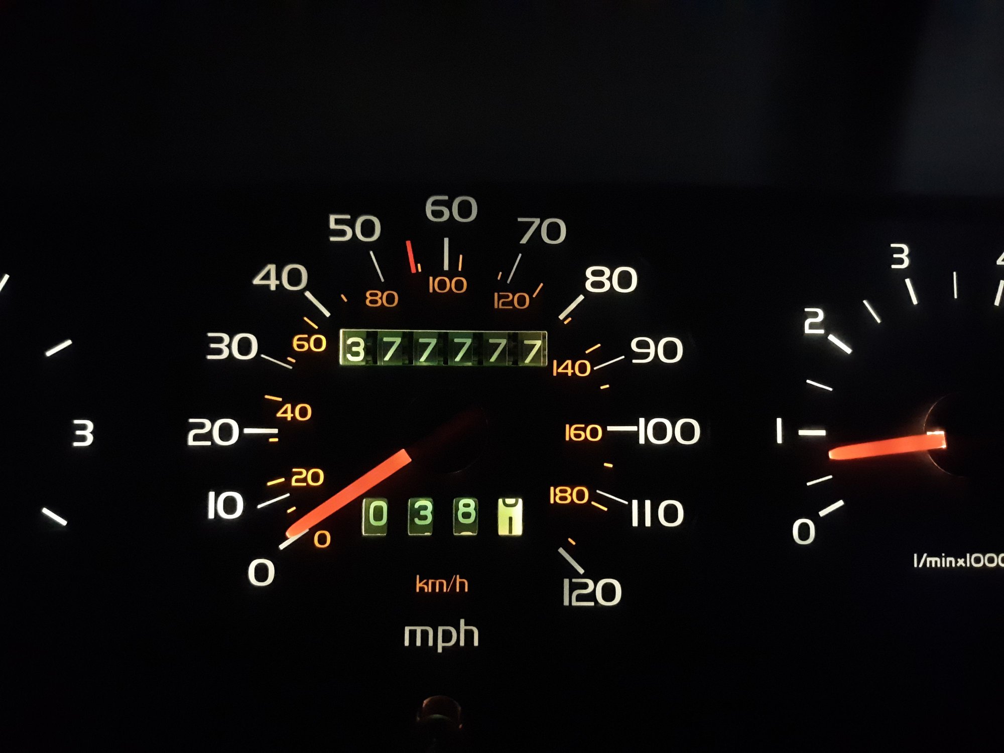

I've been through a lot over the last few months and am now driving our 89 740 with the goal of hitting 500k in the next several years. Well today the odometer stopped working at 377738 . The speedo works ok just the odometer. I assume there are some mechanical gears inside so I'll have to pull the cluster at some point and see if I can get the odometer rebuilt. Didn't do a web search yet but does anyone know of a company who rebuilds these old clusters. Everything else work . Since I replaced the ECU after finding it had problems the car runs like a top. Just letting off some steam.
Old Nov 9, 2019 | 04:44 PM
Likes: 540
The odometers have a plastic gear that can lose a tooth and stops working. IPD USA sells a replacement gear kit for $5 or so and there should be some Youtube vids or blog posts on how to remove and diassemble the cluster. I did this twice on 850s and the only advise I have is be ready for a special tool (like a #8 torx screw driver is needed for the 850's cluster) and see if you can buy new cluster backlight bulbs (as its a good time to freshen them all up).
Found them and just ordered. Thanks

OK got it and found the solution on this site. Seems that the service warning light which is triggered by the odometer sometimes hangs up the system. Solution was press in the service warning button a few times and also the mileage reset button and it works again. Also if necessary tell you how to replace the gears. Here is the site https://www.volvoclub.org.uk/faq/Ele...roken_Odometer

Working again and no issues.
