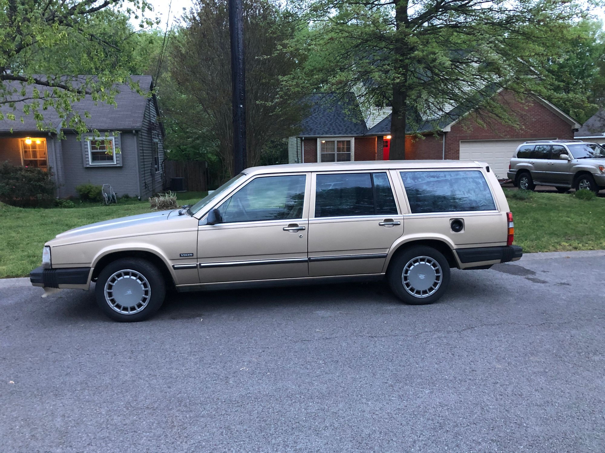

Hey there,
I just bought a 1989 740 GL and it will turn over but not start, it wants to, but just can't quite get there. I haven't owned a Volvo in 20 years so I relatively new to these motors. The guy I bought it from said a mechanic indicated it has a blown head gasket, but I see no evidence of coolant in the engine oil. I checked for codes but it came back 1-1-1. The previous owner said it was overheating and leaking coolant out of the flame trap. Any tips on where to start would be appreciated!
