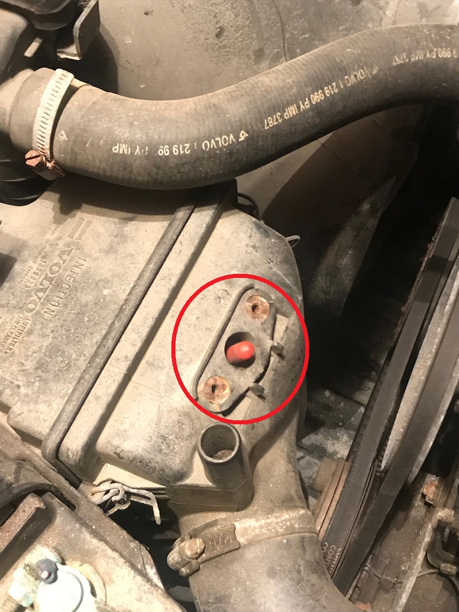

I didn't have my first Volvo (1991 Auto Wagon with 168,500 miles) home more than an hour and I was already under the hood checking things out and already need help from the experts.
1. What, if anything, is supposed to be attached to the air box where this red vacuum plug is installed? Purpose?
2. Is this a vacuum line coming out of the firewall and is it supposed to be attached to the 90 degree pipe coming out of what I assume is a one way valve off the intake manifold? Purpose?

1) nothing as far as i know
2) yes and yes - it supplies vacuum to the climate control system (if there are no leaks further upstream)

You don't need to go tearing apart the dash just quite yet. Like silvermine said, that hose coming through the firewall is supposed to be connected to the nipple on the top of the intake manifold. It is the vacuum supplied by this line that controls the flappers that changes the flow of air to the various vents according to the three button control. Also, while you are fixing this, you might want to check the nipple on the intake manifold. The black/white plastic piece there is a check valve. Make sure that air flows one way (into the intake manifold). If not, the check valve needs replacement.
