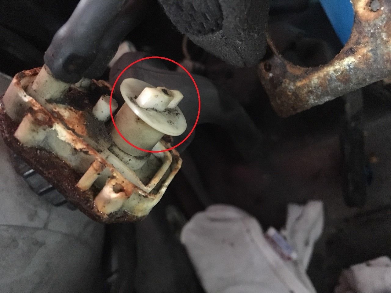

That being said, here are some pictures I took of the pump disassembled. Very simple - took me about 5 minutes.
The rotor at the bottom of the pump (circled in red) had about 28 years of crud on it. Cleaned it all up and put it back together. Voila! It works.
