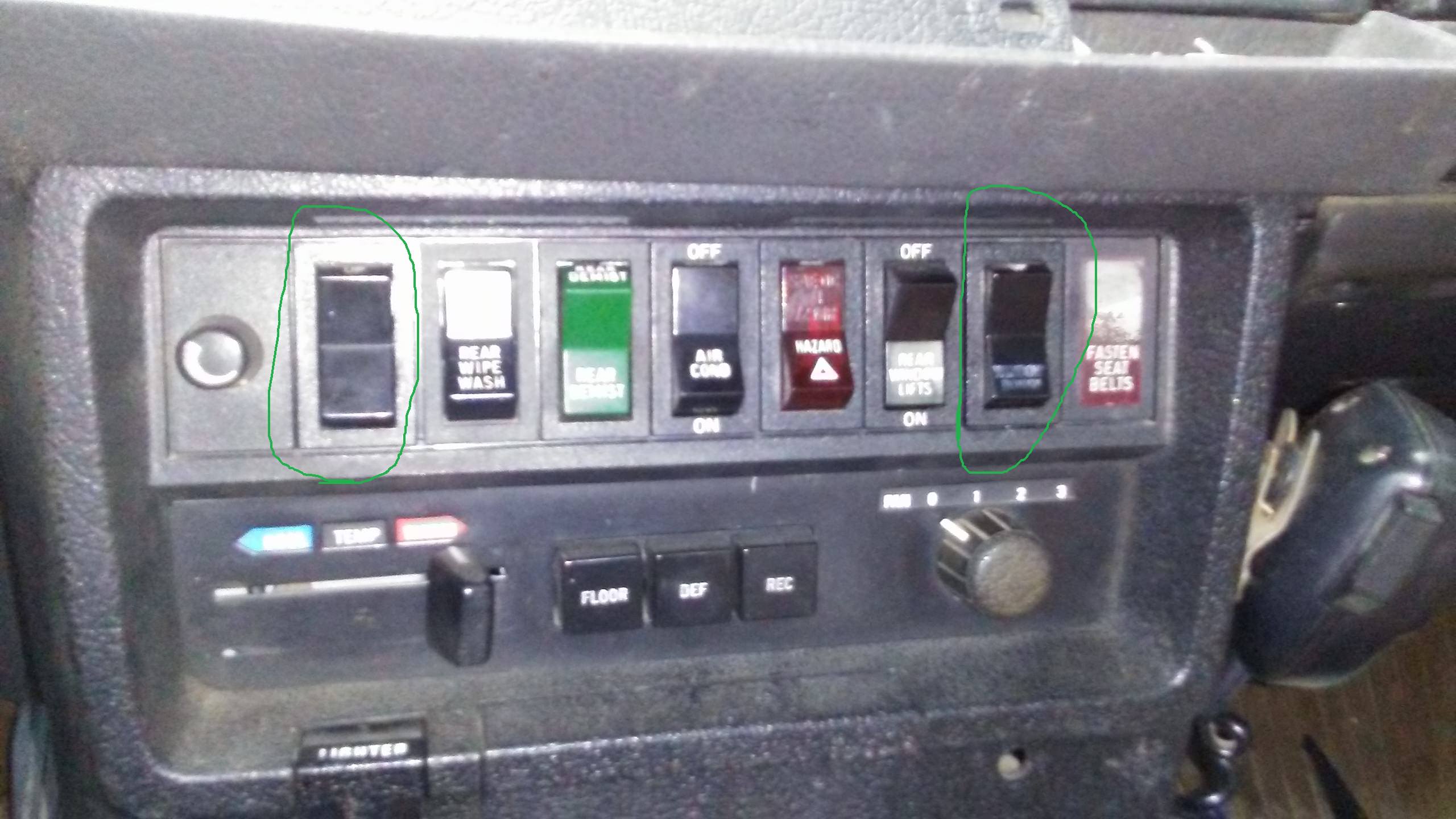

Hey guys, I just picked up this 265.
V6 with three speed auto
the power window switches aren't working very well, I already opened them up and tried to clean them but they're VERY worn out..
Anyone know where i can find replacements? I've been googling b ut what I'm seeing doesnt look right.

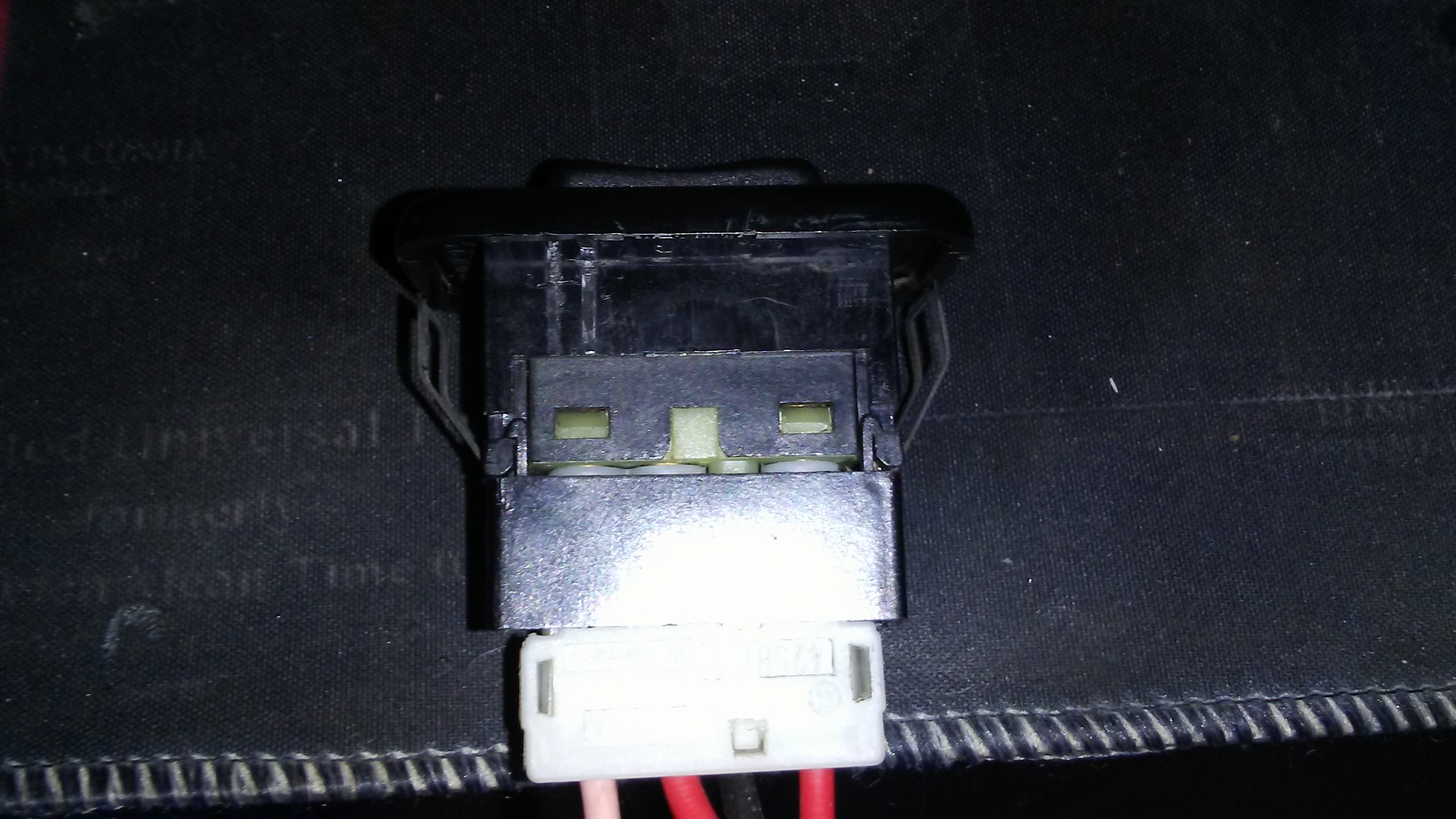

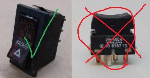

I can only find the switches that install in 240 DOORS. they are NOT the same. IPD does not carry them. the switch i'm after fits the dash, it's the same as the hazzard switch, but DPDT

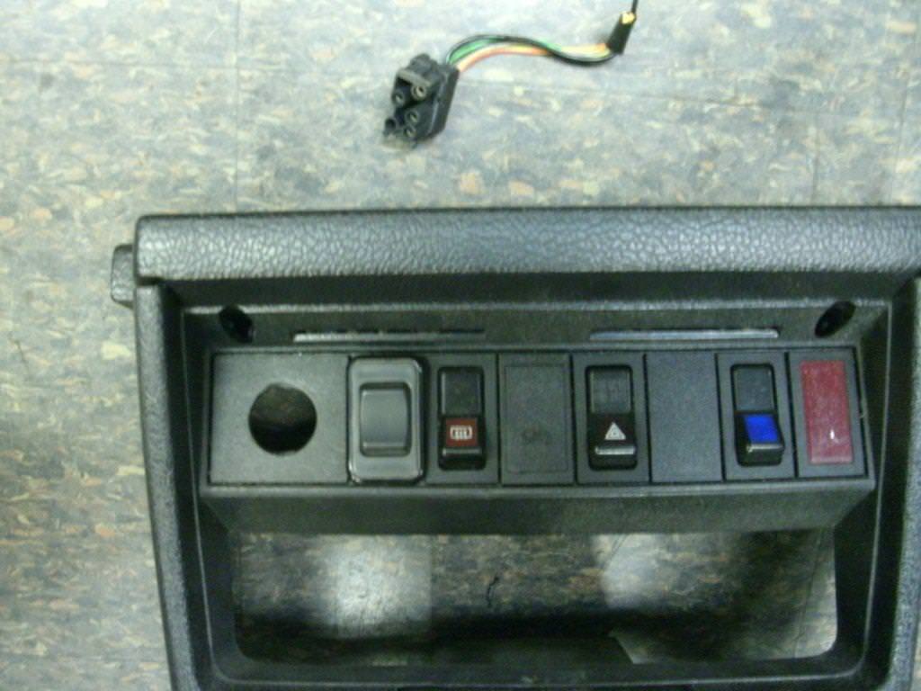

Hmm, all the switches are on the dash? Picture?

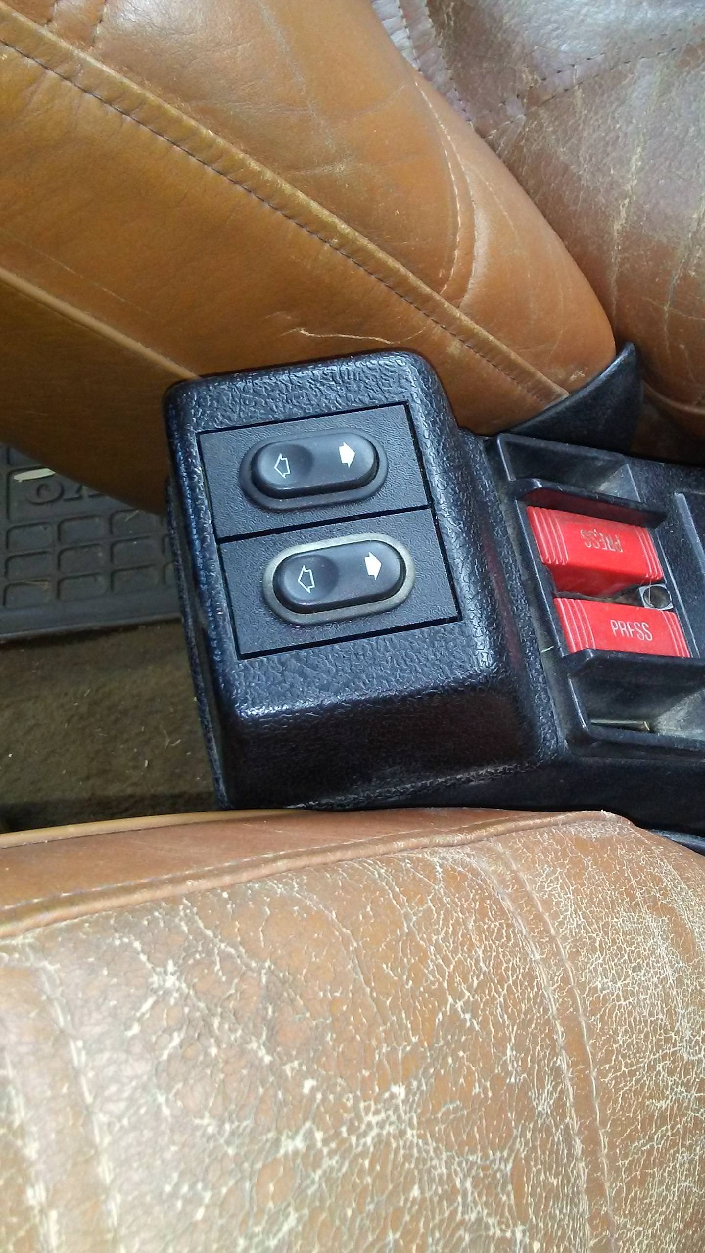

voluparts suggested using 740 switches with the holders from rear door. but it looks terrbile.. im REALLY hoping to find some of these original ones...
Old Sep 29, 2018 | 11:36 AM
santafealltheway's Avatar
Joined: Jun 2017
Posts: 30

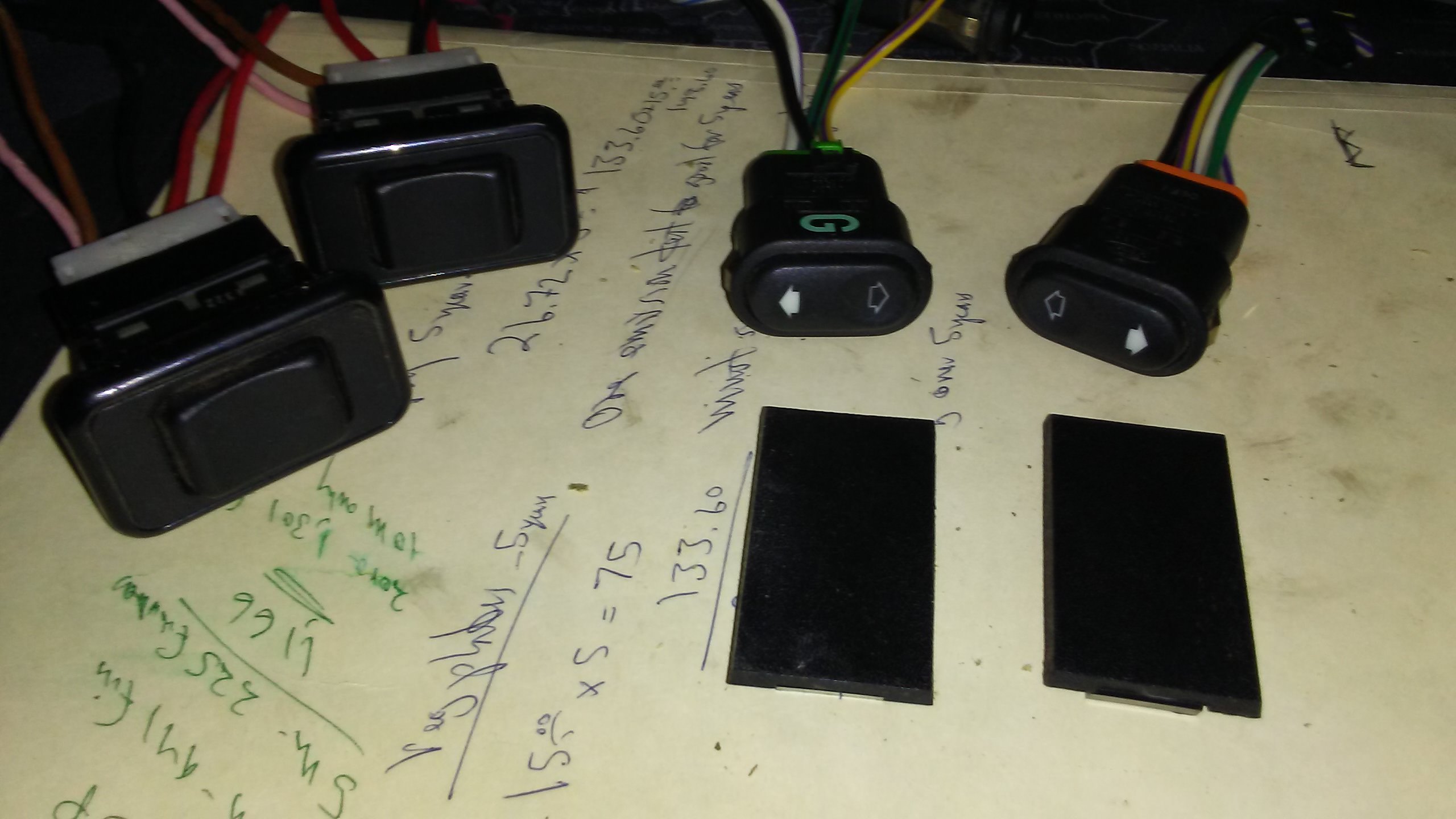

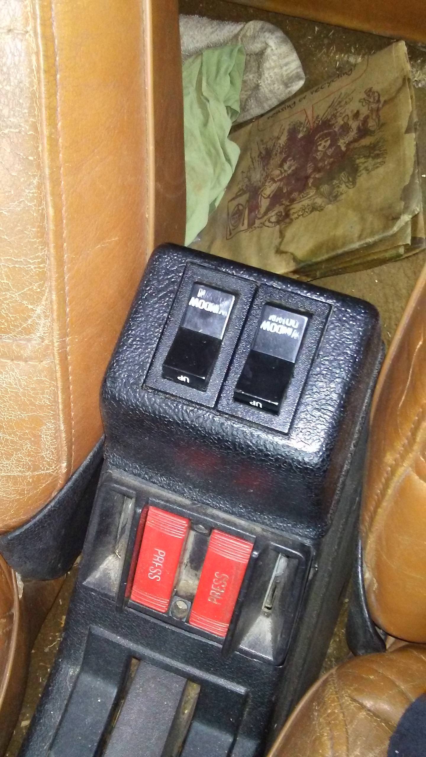

Alright I hit the junk yard today and heres what I came up with.
2 940 switches from back door, there was a 240 in the yard so I was able to test fit, they do infact clip into the 240 dash but look rather silly, HOWEVER they look nice in the center console location.

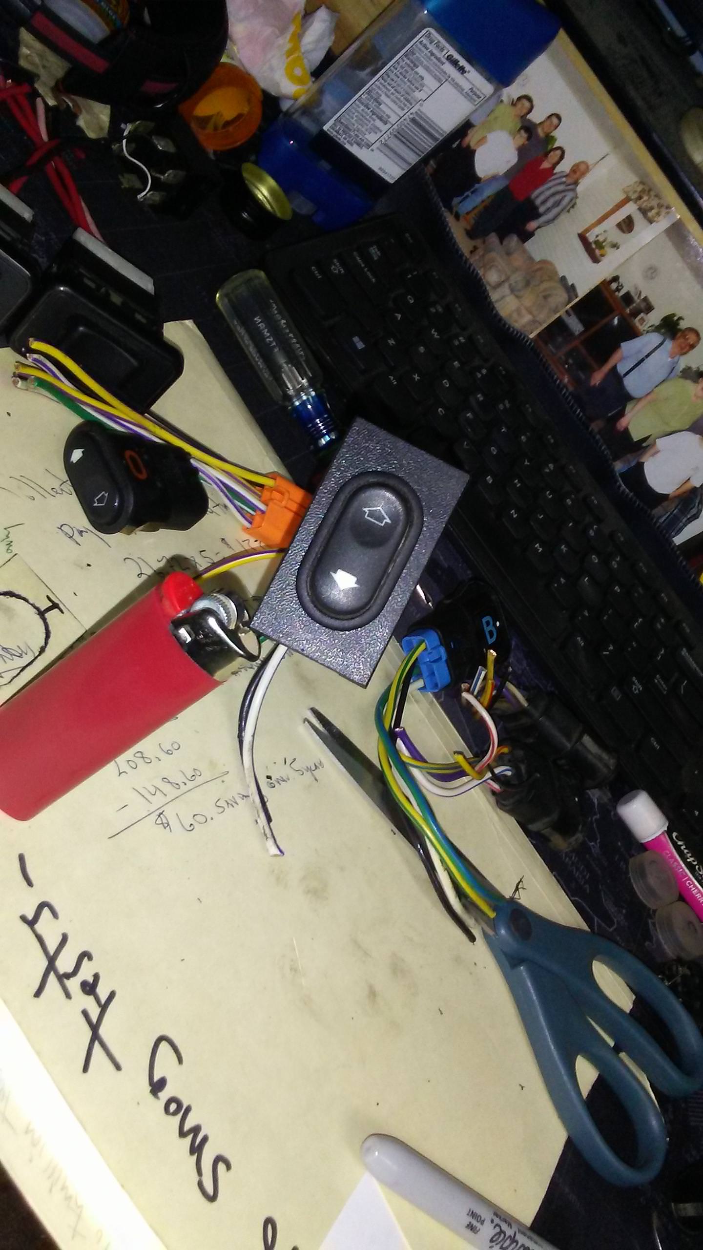

For the dash, I found 2 240 switch blanks, and some switches from a 2001 mercury cougar, ill fit them in with a little dremmeling.
Old Sep 29, 2018 | 12:09 PM
Joined: Jun 2017
Posts: 30
Not bad!

Not bad at all! After a little lube an adjustment the back windows work like new
