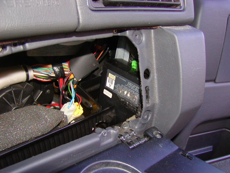

Originally Posted by Psaboic
Where did you getthe remotes at? I would like to get some for my son's 95 850 Turbo. When he bought it, it only came with one key and no remotes.
Did all 850's have an alarm and remote door locks? He does have the red LED light that blinks whenever he locks the door with the key.Glenn
Mine came with no remotes too. You need to pull the glove box out to see the receiver for the remote entry. It's the little black box on the right in the picture. You need to pull the FCC number off of it. If you order a transmitter with the identical FCC number it will work with your vehicle no matter if it's two, three or four button. Only the buttons the receiver is programmed for will work so if all four don't work that may be normal. I purchased four button remotes and only three work.
I purchased a new pair for around 35 bucks which I thought was very cheap but they've held up well, about a year now. Only problem is the icons on the buttons wore down quickly. If you pay more I think they'd be better quality but it's easy enough to remember lock, unlock

I have a '95 non turbo. How do I find out if there is a keyless remote avail for my car?
Thx in advance for any info.
Old Aug 25, 2012 | 11:34 PM
  #26
If you are asking if you car has it the only way I know is to pull the glove box and see if you can find the receiver for the keyless entry/security system. You will need to get the FCC number off of it to match up with the transmitters if you go to buy them.
The receiver is the black box on the passenger side of the opening for the glove box.
