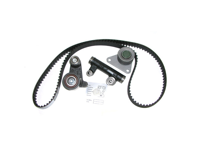

Both IPD and FCP sell kits. I would recommend doing the kit, belt idler and tensioner assembly along with water pump. If anything that touches the belt fails, you lost the belt and end up "here" again.
