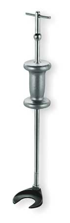

Originally Posted by ibified
Digging up a somewhat old thread here, but im doing axles right now on my 94 855, and the drivers side axle is being a BASTIGE to get out of the transmission. there's really no good place to pry on it with a screwdriver, and ive tried a hammer (claw end), cats paw, and 3' pry bar that i STOOD on and couldnt get the thing to budge
I've always been able to get them to pop out with a pair of large screwdrivers or prybars depending on what would fit. Put them as close to 180 degrees apart as you can and the axle should pop out. If it's really stuck there is a rental tool you can get at most auto parts stores along with the slide hammer it fits on.
I've done a lot of the pinch bolt style ball joints and I've never struggled that much with them. You take off the nut, use an impact if you have it to spin the bolt to break it free or do it by hand and then use a long punch to push the bolt out fairly easily and then use a pry bar or two to spread the opening a bit to break the rust loose from the ball joints stud. I douse it all with PB blaster but it usually comes apart without too much fuss. I'm in Minnesota so I know about rust and corrosion.
Attached Thumbnails  Removing the C/V Axles-cv-shaft-puller-adapter.jpg    Removing the C/V Axles-cv-axle-puller-slide-hammer.jpg

Kiss: ive looked for one of those things you posted. none of the auto parts stores around here have them for rent. bummer for me...
And yes, I'm still fighting with it.
