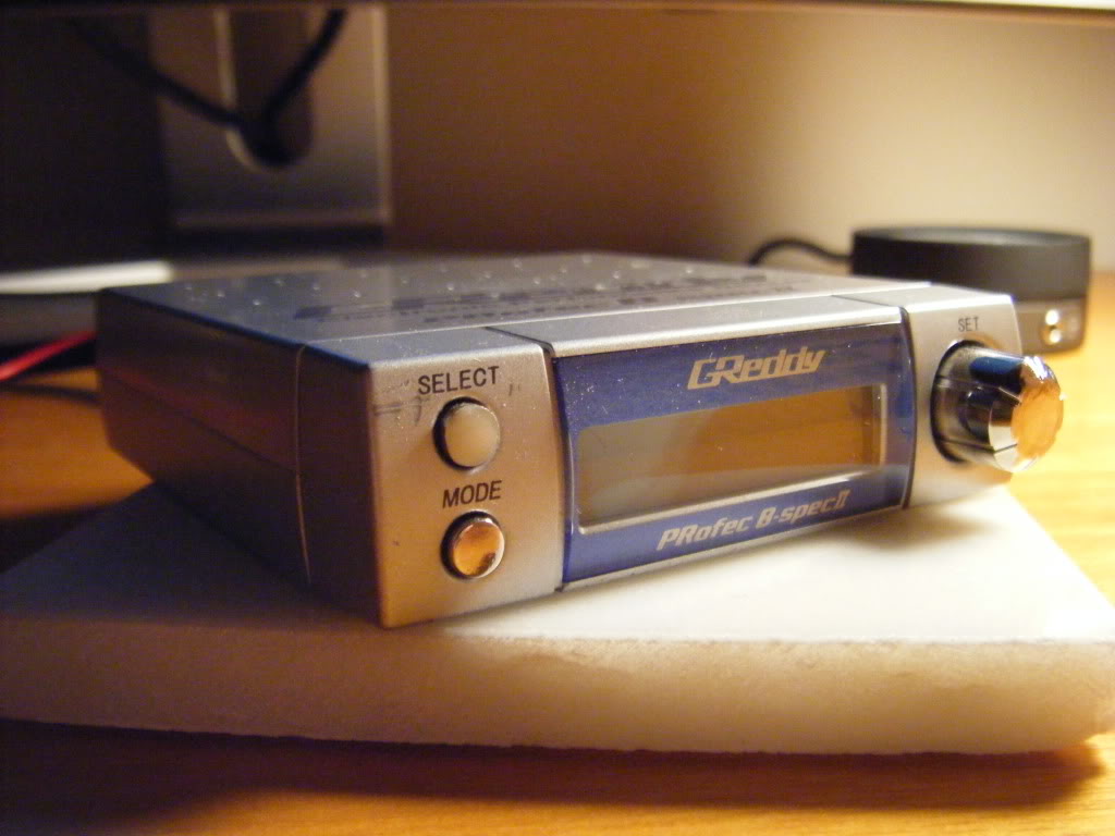

Old Feb 9, 2010 | 10:36 PM

Where are you going to mount it? I don't have very many good ideas . Hmm. perhaps you can find a way to put it in the glove box!

My plan is to make the 2nd din pocket into a mount, so it will sit flush in that. That's what I'm hoping to do.

That would look good. I'm guessing you already have an aftermarket radio head unit then?
