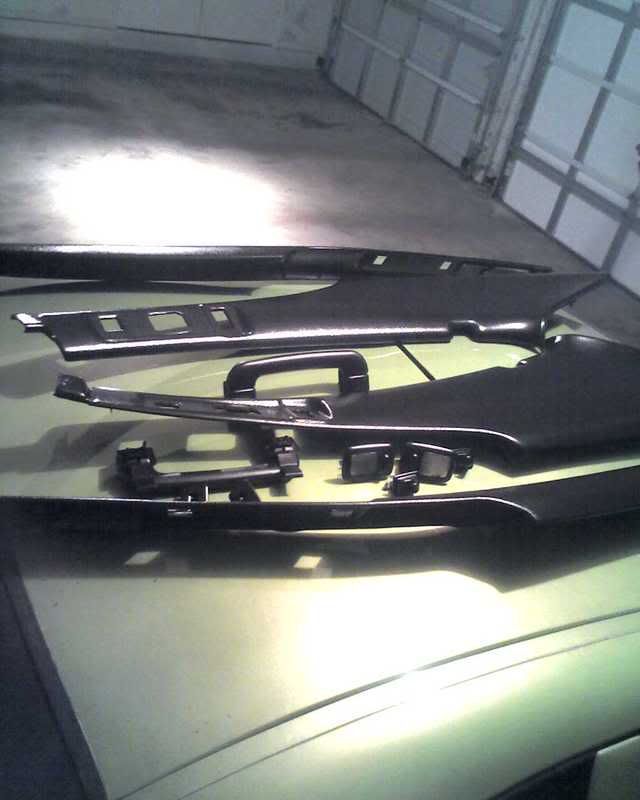

well gents, i have started my next project on the interior of my volvo. you may ask why i started such a major interior project and like most of my projects they come from being frustrated.
it all started when my headliner started coming apart and the foam was flying around as i drove with my windows down or my sunroof open. the foam would fly in your eyes while i was driving and not only hurt really bad, but impair vision. i tried to just shoot glue into the headliner and it would hold for a lil while and then fall down again and thats when i said enough was enough!
i took the headliner down, removed the falling cloth, srubbed all the old foam off and headed to the fabric store.
this is what the interior currently looks like

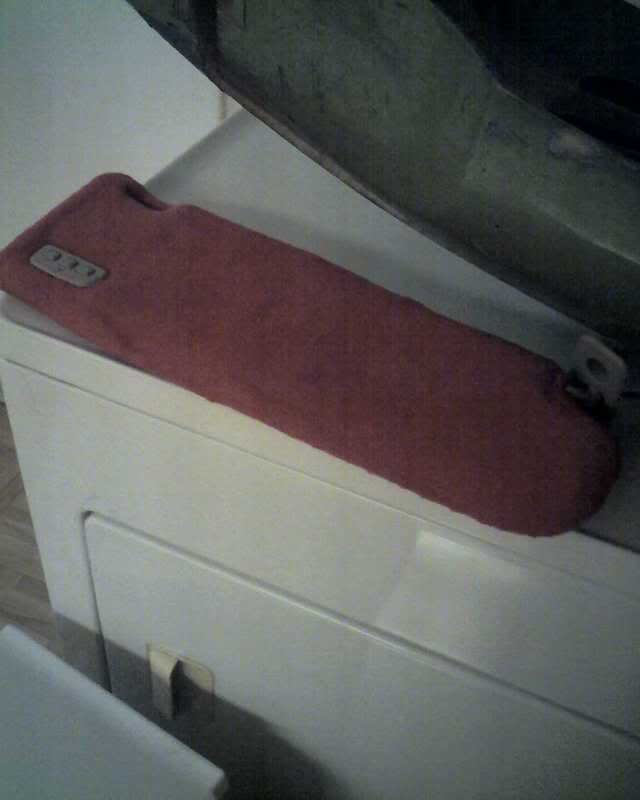

this is red fleece. yeah i know, but it's so soft and it's way lighter than any normal headliner. next is my secondary color for all the plastics / vinyl is satin black.
so, far every part has been perfectly painted cause i took everything apart as far as it could go, even the clothes hangers and rear dome lights using krylon's fusion paint for plastics. the paint chemically bonds to the plastics, hard vinyl, PVC and other stuff.
even though the paint says that you don't have to prep the plastic, i cleaned everything with alcohol and a micro-fiber cloth. i will be needing a new driver's side visor since i cut the vinyl off to wrap it with some red fleece and didn't like how it looked, so i painted the passenger one black and it looked way better.
more pics will come hopefully once i'm done and i get my digi-cam back for better pics. these were taken on my cell phone.
