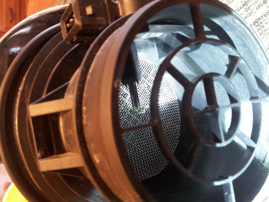

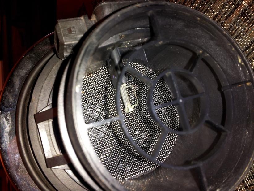

There is an almost mold looking growth at the bottom on the sensor, would that be enough to fowl it up?

looks ok to my, use some mass air flow cleaner to be sure, but visually it looks fine.
add: just noticed you run a k&n air filter. that film build up is caused by that filter. come cleaner will remove the film, and I recommend that you change to a throw away filter.
