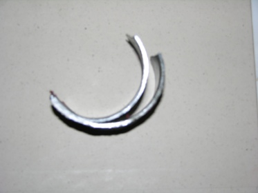

My wife"s s60 spun #5 rod bearing. Probably caused by loss of oil pressure from oil pickup o-ring going bad. I don't know how long she drove between oil changes. It is the rod farthest from the oil pump. The rest of the bottom end looks fine. The two bearing shells were welded together in the top of the rod and the bolts were hand tight.

Forgot to add: 2001 T5 with 95,000 miles. Can't say that neglect wasn't part of the equation. I don't know how far she drove it with the ck engine light on and I doubt I get a straight story from her. I will say I'm not that impressed with Mobile 1. I've been building engines for many years and this engine was pretty nasty inside.

When were all your oil changes done? Every 3k or 7,500? The was the worse thing Volvo ever did was go to a 7,500 service interval!
Turbo cars should be every 3K N/A should be 3K as well but can be stretched a little more. Turbo cars should be done at 3K on the dot.
I just got done rebuilding my 850 motor that spun a bearing. But that was from me racing it. Not sure if it was oil temps or not.
But 2 things that kill the bearings are lack of oil and really high oil temps. I doubt your car had really high oil temps.

I'm pretty sure mine was lack of lubrication due to too many miles between oil changes. It's my wife's car and I wasn't keeping up with the mileage. I went to the engine shop today and 1 main was gone but the pistons looked good.
